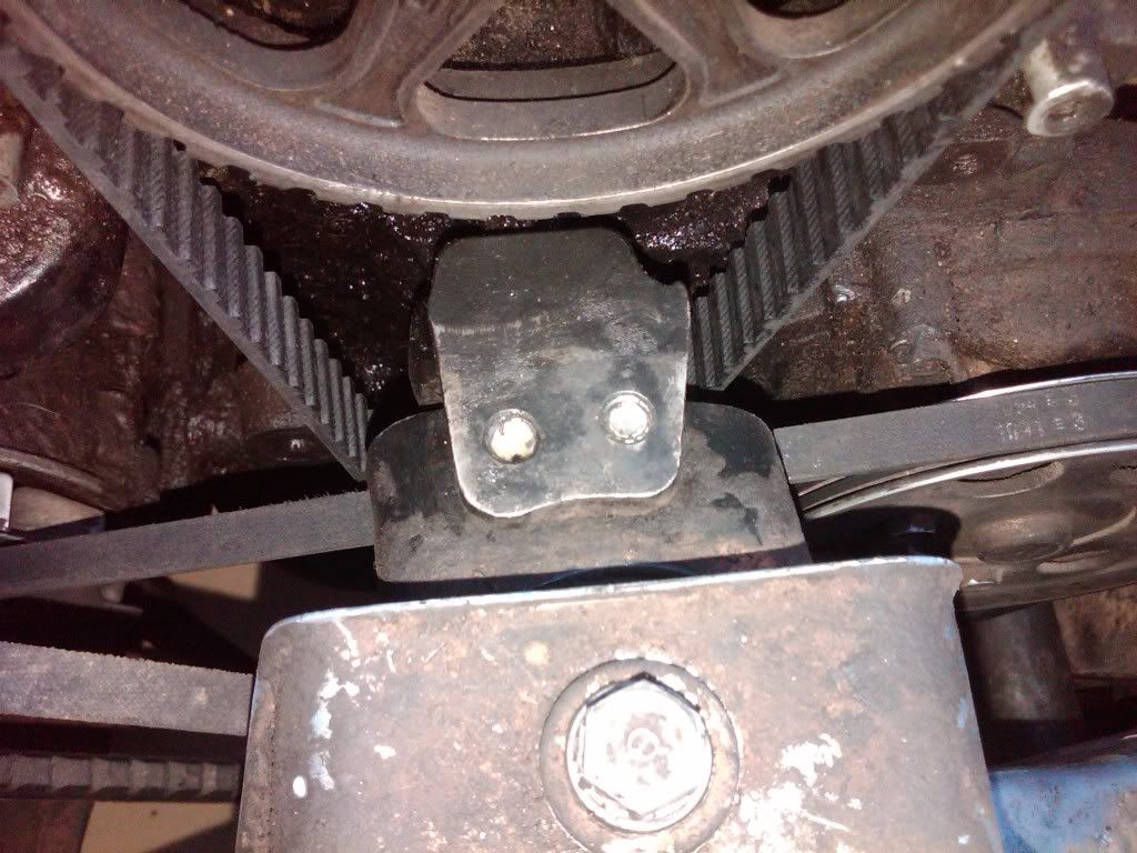

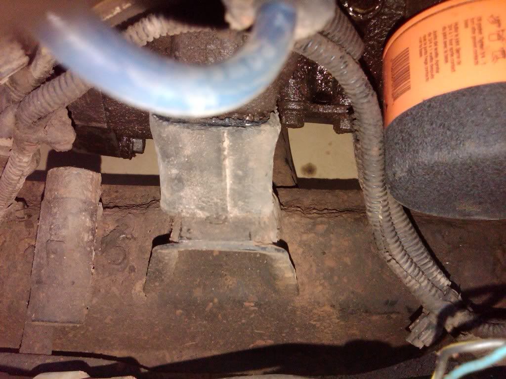

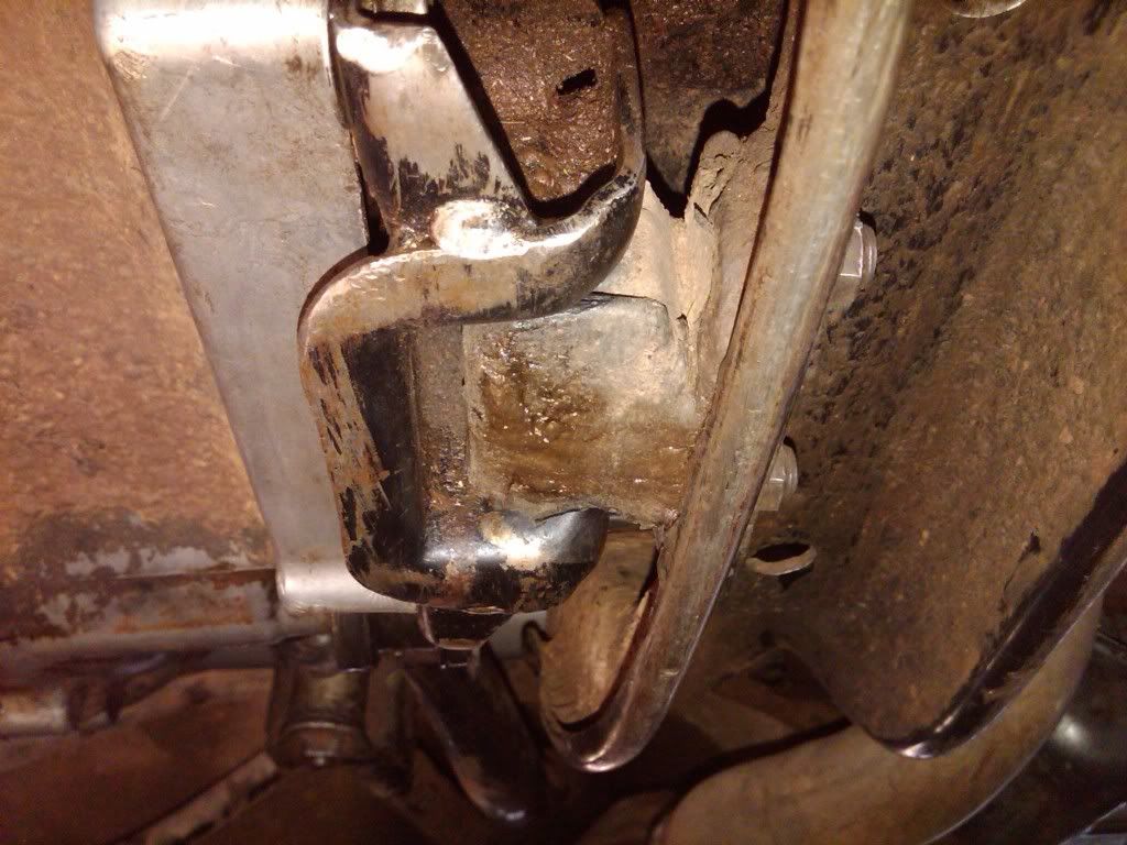

    Re: Im pissed !
    heres the pics of the mounts
    I know I know it looks bad
