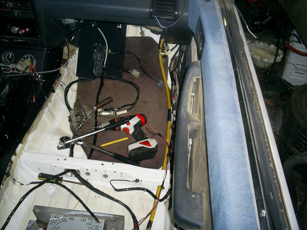

    I finally got a little done, the battery box is bolted in, the washer tank in, and i'm finally running some harnesses permanently. it shouldn't be too long until the passenger side up to the firewall is finished. I'm using these old factory floor mats as a template to eventually have some new ones made, i'm modifying them to fit around things, and i'm going to have to add some material.

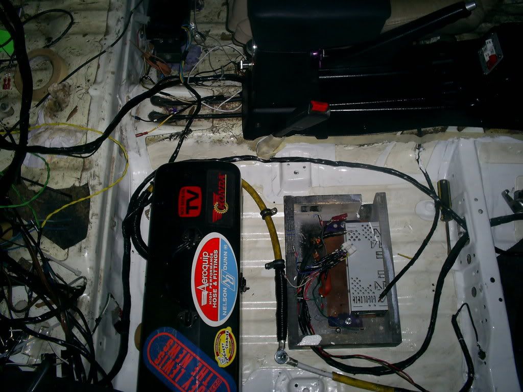

    battery box in, and you can see where the radio box goes. cover is off in this picture, but it has cooling fans also.

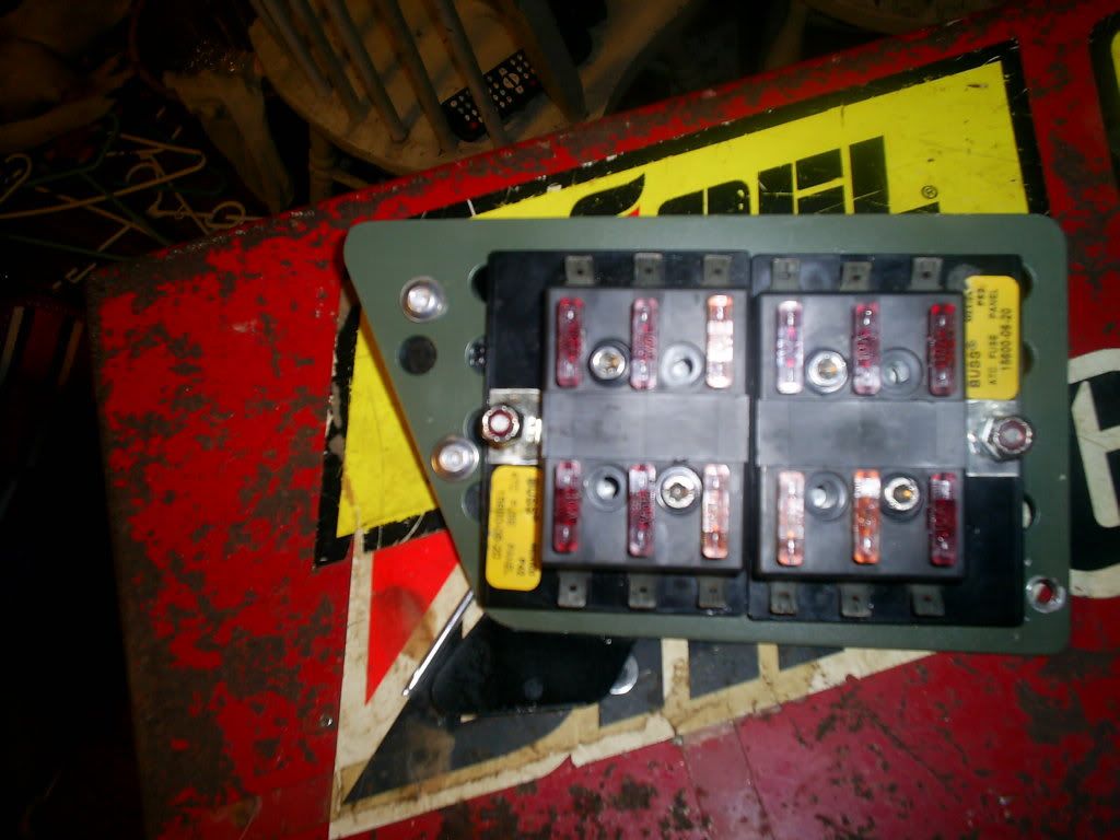

    I made the bracket for the main fuse block, I'll need to make another bracket to hold down one side, I drilled 40 holes in the bracket, all within .0001 of each other, I wasn't sure how many would show, but the bracket is plenty strong and weighs about an ounce lol. this is one of the primary fuse blocks, I need to rip the center harness i made apart and route all the power wires back the other way now, instead of to the battery box,

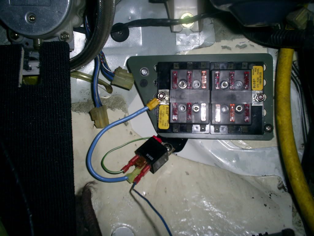

    I ended up cutting an aluminum baking pan for material and made the lower mounting bracket for the fuse panel.

    fuse panel mounted, and relay for ignition switched side of panel. When I have some money I'll be ordering some boots to cover those fuse panel terminals.
