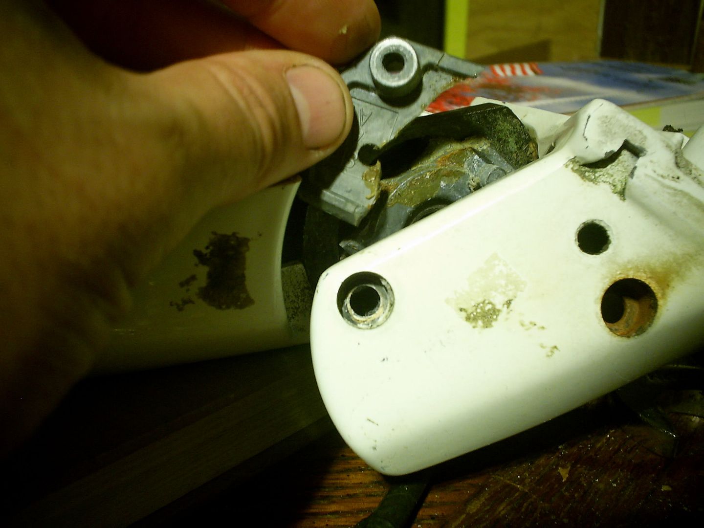

    here's the broken piece, you can see the old glue, this might have been working for years on this repair but finally gave up, stupid pot metal.
    Re: power folding mirror video
    jb weld i know its not your style but but its an easy fix or try and have someone find a set that is only that side
    I'll try it's under the trim so i could care less what it looks like, but thats a heavily loaded piece so I don't think the jb will hold. thats what actually anchors the base to the mirror.
    I could order some super alloy one pot metal repair welding rod from muggy weld, but i can't afford it right now, it welds pot metal at 350 degrees. plus the motor would have to be dismantled. Jb weld is just not going to hold a loaded piece like that, it needs to be welded. actually brazed .
    idk if the glue held i dont see why the jb weld wouldn't i would at least try
    Ok someone on another site i belong to is sending me a couple of those special pot metal welding rods, now i need to take the motor apart, and get that piece out. the reason the jb won't work anymore, is the parts have been moving against each other and have worn themselves down. this special welding rod will fill in the gaps. I'm not giving up yet. these are too rare to give up on.

    this piece goes all the way through the motor gear box, I believe it even has gears cast onto one end, no way to machine it without a cnc and tons of work and encoding. I've got to take the motor and gear box all apart to get the metal piece out, then it can be welded back together hopefully. and the info on the bases was correct, the bases don't fit the hatch, it was very easy to swap mirror bases.
