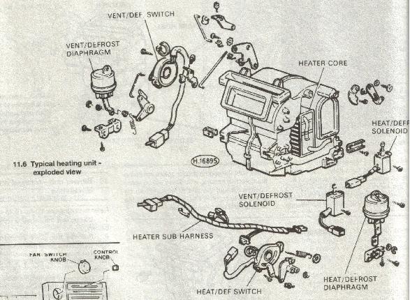

    My book shows two electric solenoids. If you can't hear either one then it may be a fuse.
