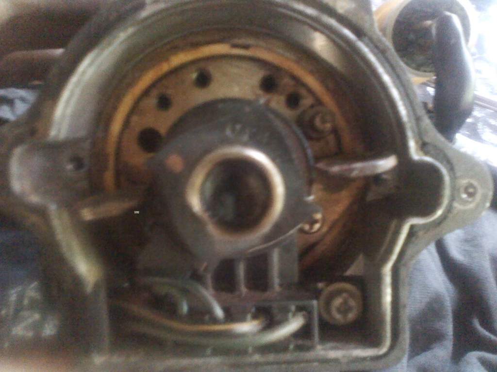

    Hopefully someone who did this tutorial can help me although snoozes tutorial is great theres just a few things im not sure to remove here. I'm more of a visiual learner than and just reading so hopefully someone can help me out with this. Click image for larger version.
ID:	7494 I'm wondering what to remove from here on out I got the vacuum off. I didn't want to remove something that would mess the thing up. Is it just the two screws on the bottom then pry?

    Thanks for the advice on the gap looks good from what i can tell no chips or anything. As you can see I already got it out just trying to get to the mechanism so I can clean it up like Snooz's tutorial hopefully I can get the last two screws out so i can access it. Thanks for the help man.

    I think you posted that picture about the same time I post so I never saw sorry about that.
    Only thing I can think of is the ignitor is not grounding well. It needs a very good ground to work correctly. Or one of those pins are not contacting good.
    The timing might be off some but it would idle just fine where ever it landed. The distributor can only go in one way on Hondas as far as I know. Domestic it can be inserted 180 degrees out.
    Inspect everything again inside and make sure the reluctor/stator is not hitting.

    Wires ended up being fine. The reluctor and stator were actually hitting each other which was causing such an issue. Ended up buying a used distributor from AZMike on here which I used and it worked good. Started up nice and fine ill let you guys know how it drives.
