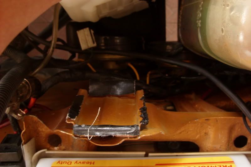

    Well, this isnt your typical wire tuck, im just trying to solve some issues with my electrical system and decided to clean up some wiring mess. I pretty much had the whole harness rebuilt from scratch.
    I cant do full tuck unless I start drilling random holes to run my wires to the inner fenders. Plus there isnt much I can do unless I move my battery to the trunk, which is something I'm considering someday since I'm really short on cash at the moment.
    Dont expect too much from this as the main goal for this is to fix my electrical issues.
    Supplies.
    You cant see much here but theres 3424324 wires underneath the washer reservoir
    Slight mess
    Battery removed and the work has begun!

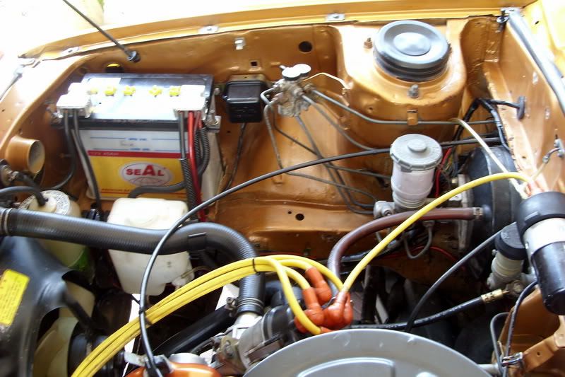

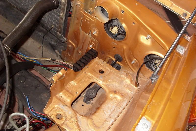

    Re: Started my wire tuck, sort of
    My assistant
    Few mins later >.<
    I moved the stock wires running across the firewall to the front, underneath the radiator
    My new horn location
    Tucked the headlight wires, and fuses for relays for my headlights, high beams, fogs, horn, fans and AC compressor
    I didnt have pics, but I found out that the A/C subharness for the cooling fans doesnt have any fuse for them. And to make things better they decided to use tiny gauge wire for the ground, which ran from the fans to the relay located near the pass side shock tower, while the positive wire is in normal size (12 gauge maybe, I'm not sure but its pretty thick) for 2 fans running roughly at 30A. I'm pretty sure the harness is stock.

    Looks like a fun project! Obviously those aren't stock relays and fuses you have there, are they?

    Not fun with bad back. And yeah they aren't stock except for this for AC: http://img.photobucket.com/albums/v1...k/SN851032.jpg
    And I'm going to repaint my bay someday. Right now I need to get this done by today, need the car on Sunday

    What are the extra fuses on top row for? I have 1 on the left side for radio and 4 on the right side for headlights/high beams.

    lol I did and its a daily driver.
    I can say its done for now, I still need to repaint the bay and parts and pieces. And to clean up the slight mess near the battery terminal. Will do those next time since I need the car today lol. Its taking way longer than it should, thanks to my OCD with keeping all my wires neatly organized.
    Hope I can move my battery to the trunk next time
    And I had my battery light coming up at high rpms. That freaks me out at first thinking I might have wired something wrong and fried something up. After 3 hours of fiddling, I found out that I have one bad ground and its freaking the whole electrical system lol

    Hey is that torque rod from the firewall adjustable? Looks like it's threaded... Mad tyte JDM? I like where you put your coil too.
    Yes, the torque rod is adjustable.
    The ignition coil is located there from factory, mine has it there also.
