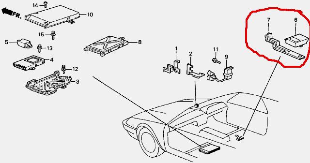

I honestly don't know what that could be, but I'd start by checking the fan timer relay. It could be freaking out. It's one of the modules under the passenger seat. You can also check the fan relays in the under hood fuse box. In the '89 manual, available here, the section begins on p. 25-110. Good luck with that.
First you need to identify which cooling fan is coming on(most likely condenser fan, drivers side) The fan timer is activated for up to 15 minutes after key is shut off. The timer will activate this fan if coolant temperature reaches setting if coolant temp. sensor located next to the TW sensor.(NOTE: these sensors are the same for 86-87 lxi and the same for 88-89 lxi). For this time of the year the most probable causes would be 1-thermostat failure or 2-faulty coolant temp sensor. It could be a fan timer, but yet to see that on accords. temp gauge can read normal and still have a bad thermostat. fan timer failure is really common on 86-90 Legends.
