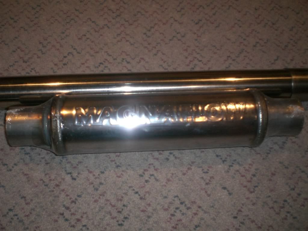

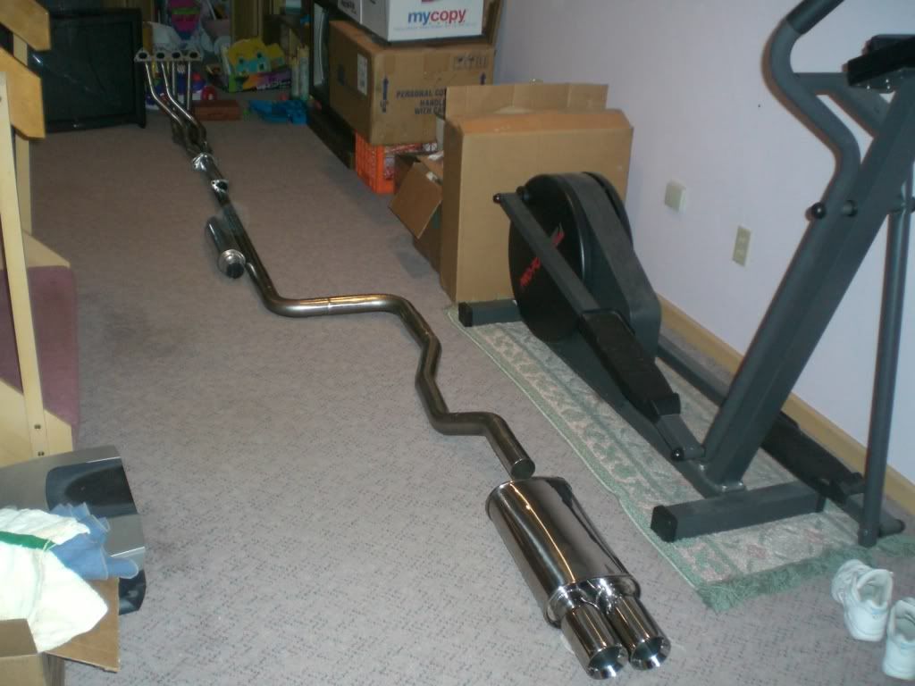

    so my current exhaust is:
    JDM ITR header w/ 2.5" outlet
    a napa cat
    thrush glasspack as a resonator
    2.25" piping to a dual outlet muffler
    the new setup will consist of
    Rage TriY header w/ 2.5" outlet...I may upgrade to the big tube design
    2.5" test pipe from Kteller
    90-93 Accord Kteller stainless steel exhaust piping kit...DO NOT BUY FROM KTELLER!! you can buy this kit directly from VRS exhausts as that is what they do but mark it up by $40-50. from what I can tell it will be a little long, but will be easy to trim. I did not want to buy a nice exhaust for the 90-93 accord and then have to hack it up
    Magnaflow 2.5" resonator
    Vibrant Performance 2.5" 1040 muffler

    Nice, I didn't know about that VRS Exhaust. I'll probably buy from them next.

    So the 4G exhaust does fit, then? I read that the turn for the fuel tank was the part that needs some work., do you know what all has to be messed with?

    I do not know how it will fit YET. All I can tell you is that the bends look similar and because this is a kit and it doesn't have actual flanges; it will be easier to modify

    nice Steve. Hey, now that you're legal, bring that exhaust down to my house when you come and we'll mock it up if you want. Now that I see the pics, the only thing I foresee (other than overall length) is the length of the bend in front of the tank. I'm guessing that'll need to be extended a bit. Nothing a tubing stretcher, and that extra length of tubing they gave you, can't fix.

    Keep us updated on the exhaust thing. I need to upgrade mine.
