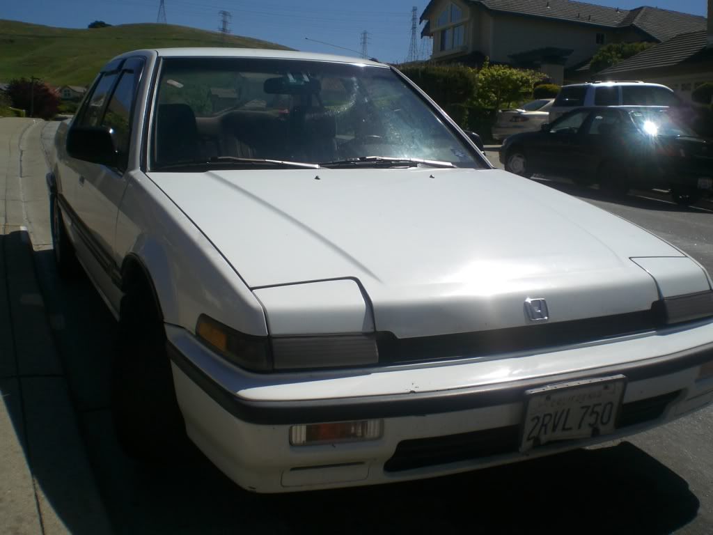

    Oh...before i get started here's the pics before all the new stuff
    https://www.3geez.com/forum/showthread.php?t=66272

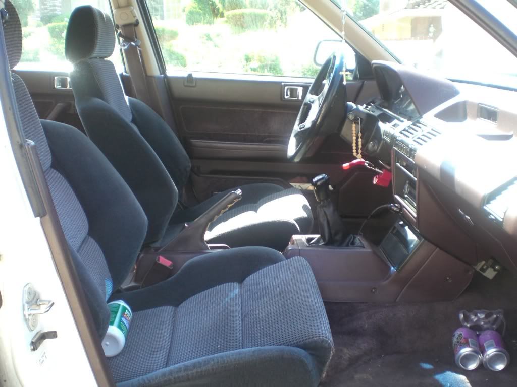

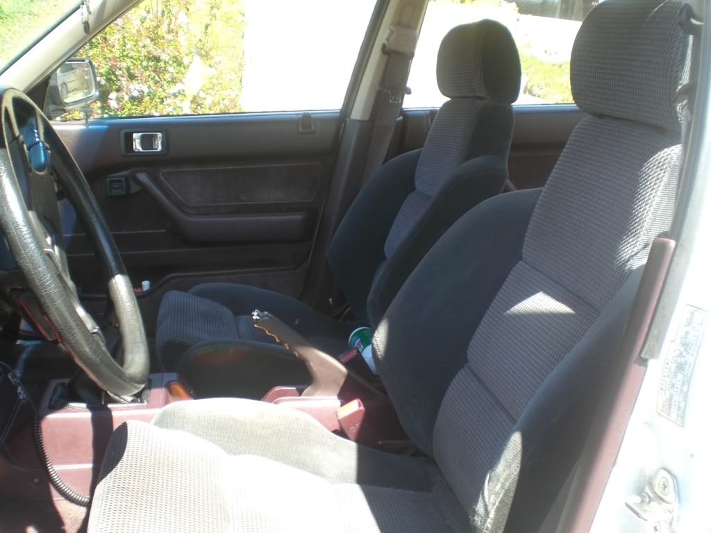

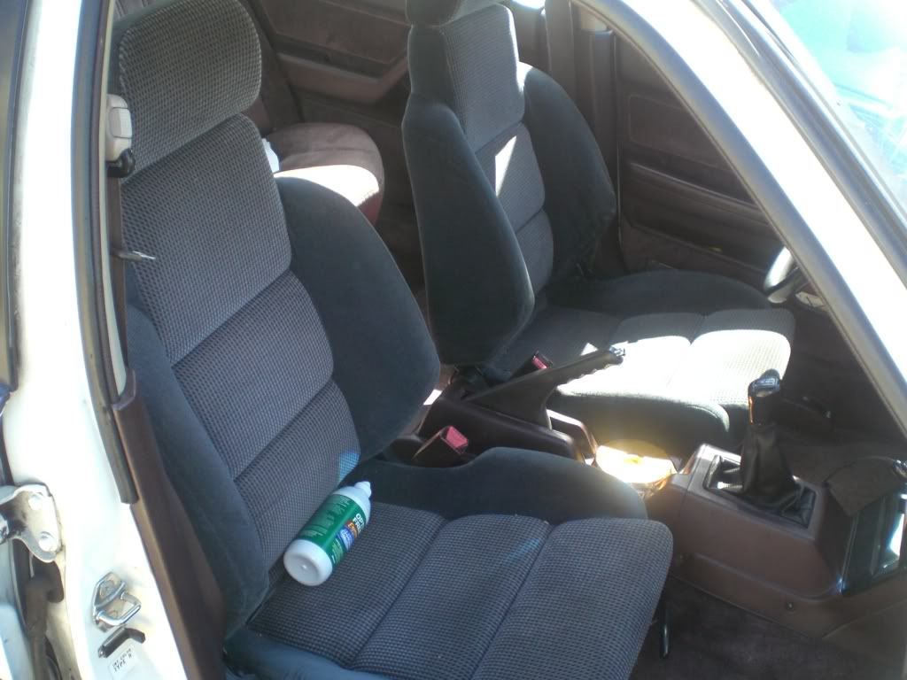

    '91 Prelude seats

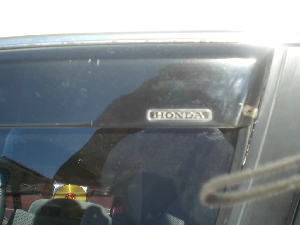

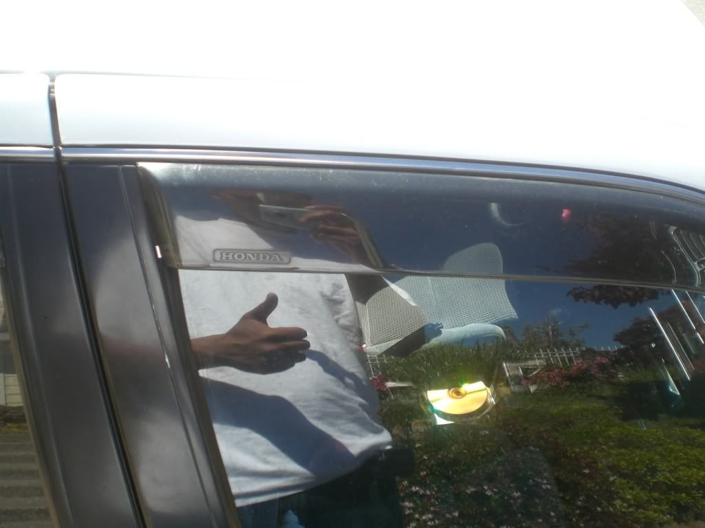

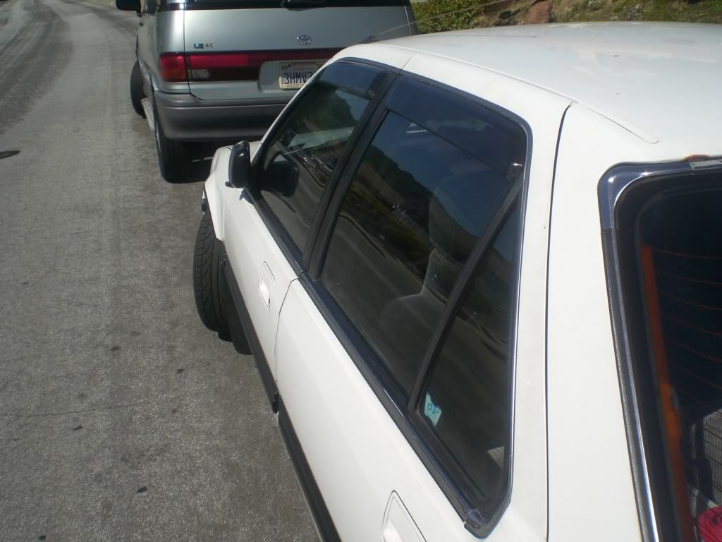

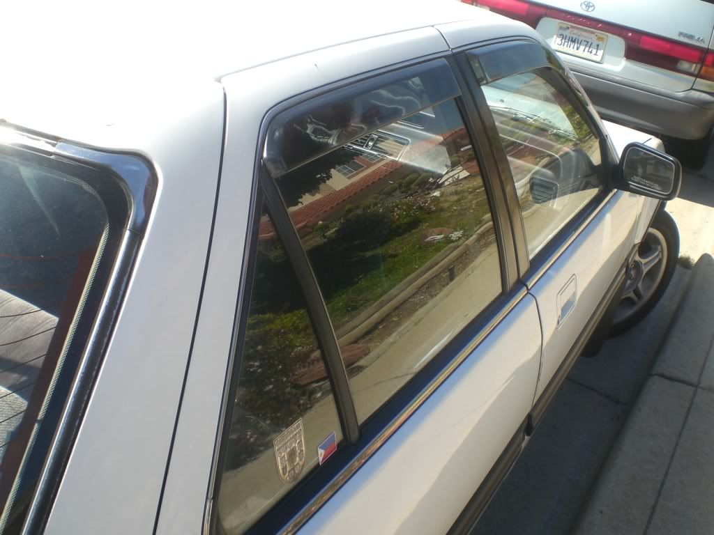

    Honda OEM Visors Thanks to 3geez member: TypeG (Great seller btw)

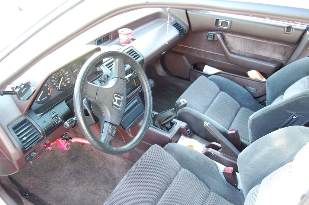

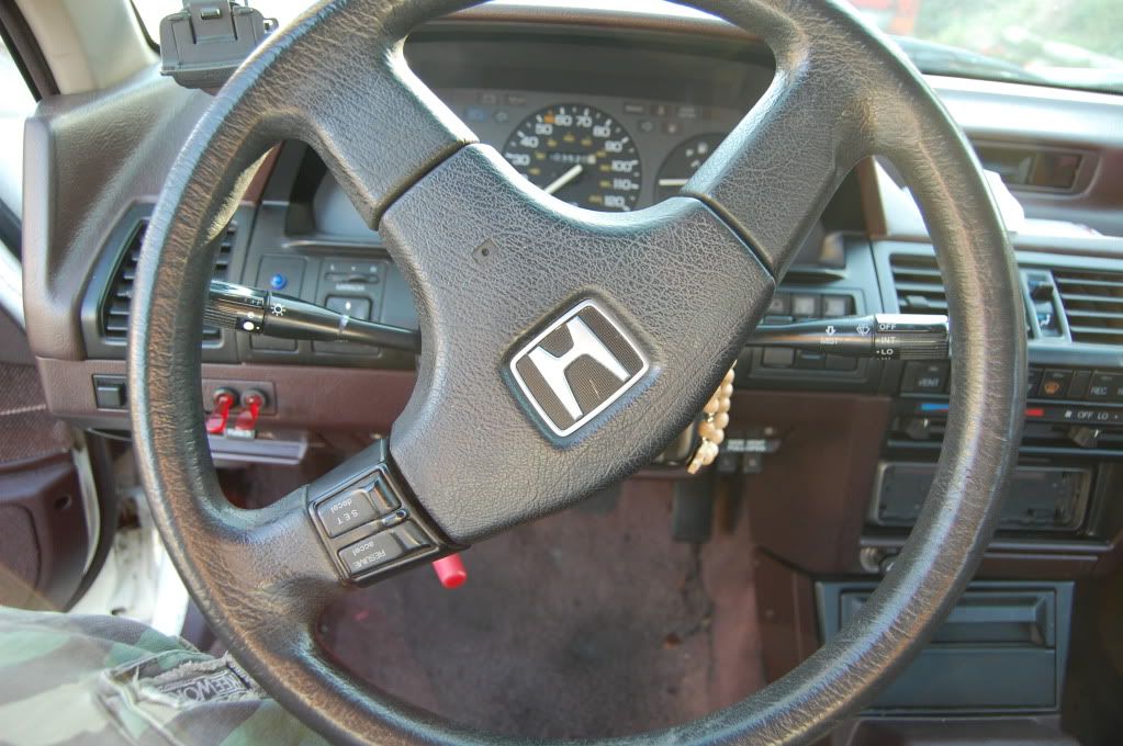

    Lude wheel
    Skunk2 Billet Aluminum Knob

    The Visors look sweet

    Visors ummmmm.

    Visors ummmmm.
    That's what I said

    those are some mint looking visors!
    yea thanks to 3geez member TypeG ever see him posting ad's i'll tell you now he's trustworthy and prompt.

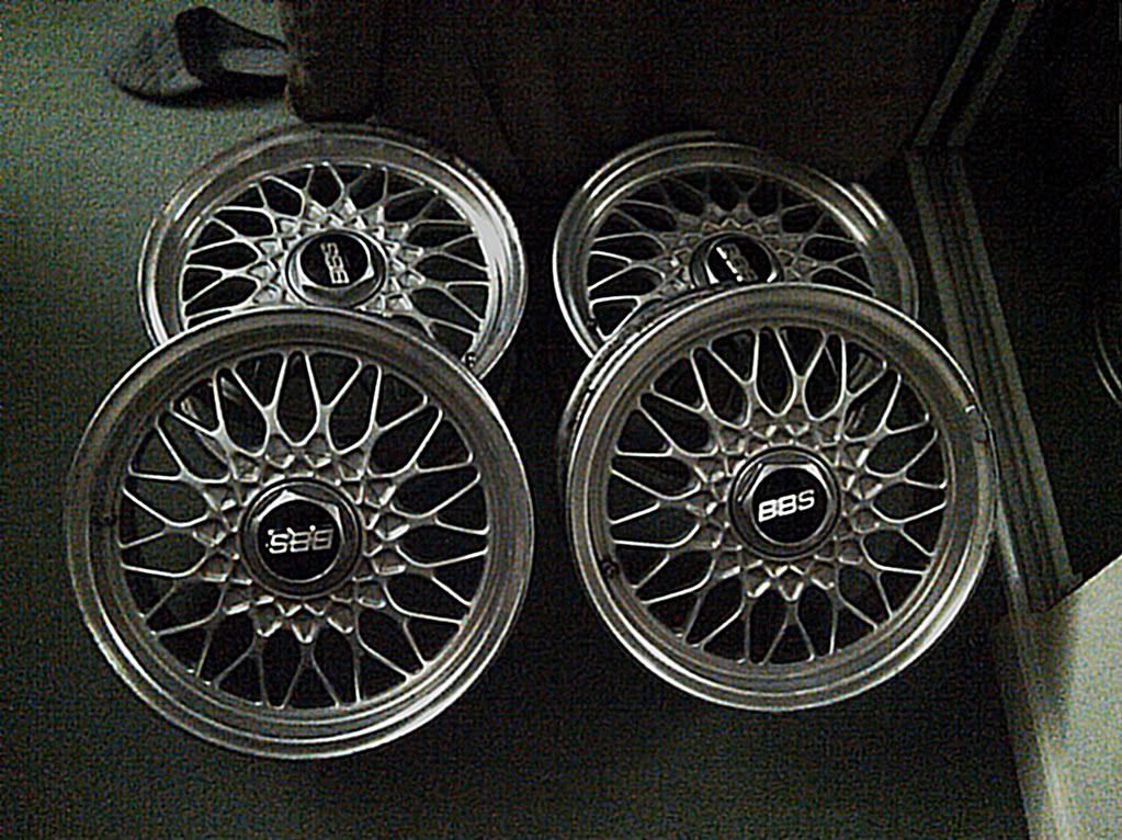

    loook what i found
    They came off an E30 bmw, 15x6 bbs forged aluminum

    those look pretty good, good find, i hate it when tire shops put wheel weights on the front of nice wheels... it's not a steelie for gods sake...

    Nice find man!

    Sweet looking
    Yeah they're annoying, when i get my tires mounted on these wheels i'll ask if its possible to remove them and if wheel weights are needed to place them inside, but I've been told that sometimes wheel weights can only go on certain spots for certain rims so i might just have to live with it...

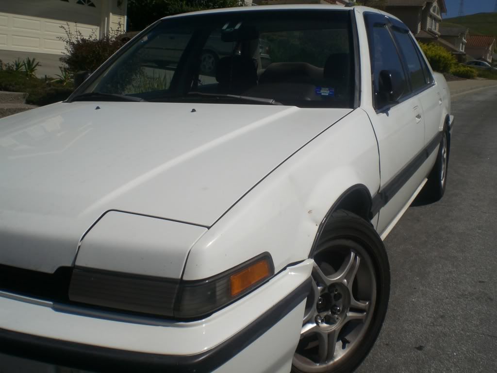

    That's a good-looking car right there. Good luck with it.

    Was it tough to get the Prelude seats in? I'm scouring the junk yards for a clean set to put in my 3g. And does the Cruise Control buttons on the Prelude wheels work or are they just dead buttons?

    thanks, just a few minor cosmetic damages to take care of still though...
    not really, all u gotta do basically is take of the rails from the accord seats, and the seatbelt plugs, cuz they seatbelts plugs on the lude seats wont work, then theres a total of 2 new holes that you'll have to drill on the rails to match up with the seats, you can basically figure it out by lining up the rails with the bottom of the seats.
    When you get the seats at tha j/y though take of the rails there, cuz i think they'll charge you less without the rails
    and yes the CC buttons work, you'll see what plugs in when you take off the wheel... good luck

    Awesome! Thanks! Lots of work planned on my Accord. lol and those were two of the biggies for the interior. Already installed an Integra Type R shift boot and knob last night.

    You needed a spacer or something for the Prelude wheel, right? I tried to install mine and it doesn't turn right, as it rubs the steering column cover.
    I think I messed my Prelude wheel up too. I couldn't see the screws to remove the face and just undid the bottom one and folded the face up to access the bolt at the junk yard. DOH!
    you need to trim a little off of the back of the prelude wheel so that it wont rub.

    Dude pico how come i cant get my wheel to mount straight, and as far as i see I'm lining up the holes the way they should be...no matter what i do it always leans to the left or right =(
