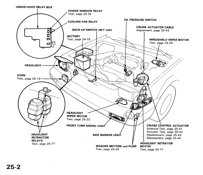

    For my reference: My laptop is portable, but it doesn't like to load Autozones whole diagram.

    what diagram are you needing? i have all the factory diagrams even the overseas ones

    I need them to be a little more organized!! lol... Those 2 big-ass relay looking things right next to the radiator fan are what I need to know.

    Re: Bass Man's got a HATCH!
    Quote Originally Posted by Bass Man View Post
    Nothing like having 50+ wires unwrapped. heh
    should be the relays for the pop up lights
  21. #71

    Freakin' sweet! Speaking of pop-up relays, I might just go ahead and wire up some sleepy-eye's. That would be cool.
    I wish there was one of those for the whole engine compartment! All I need for my setup is the alternator and starter.
    tell me what you need i have all the pop up light wiring diagrams etc. I don't see a way to do sleepy eyes, unless you rig a limit switch halfway up and some relay circuits to change that to the default limit switches. there are two limit switches per light motor, one for up and one for down. you would interupt the up limit switch with a double pole double throw relay, if the relay has power it closes and changes the limit switch to the one you added and it goes into downs syndrome mode.
