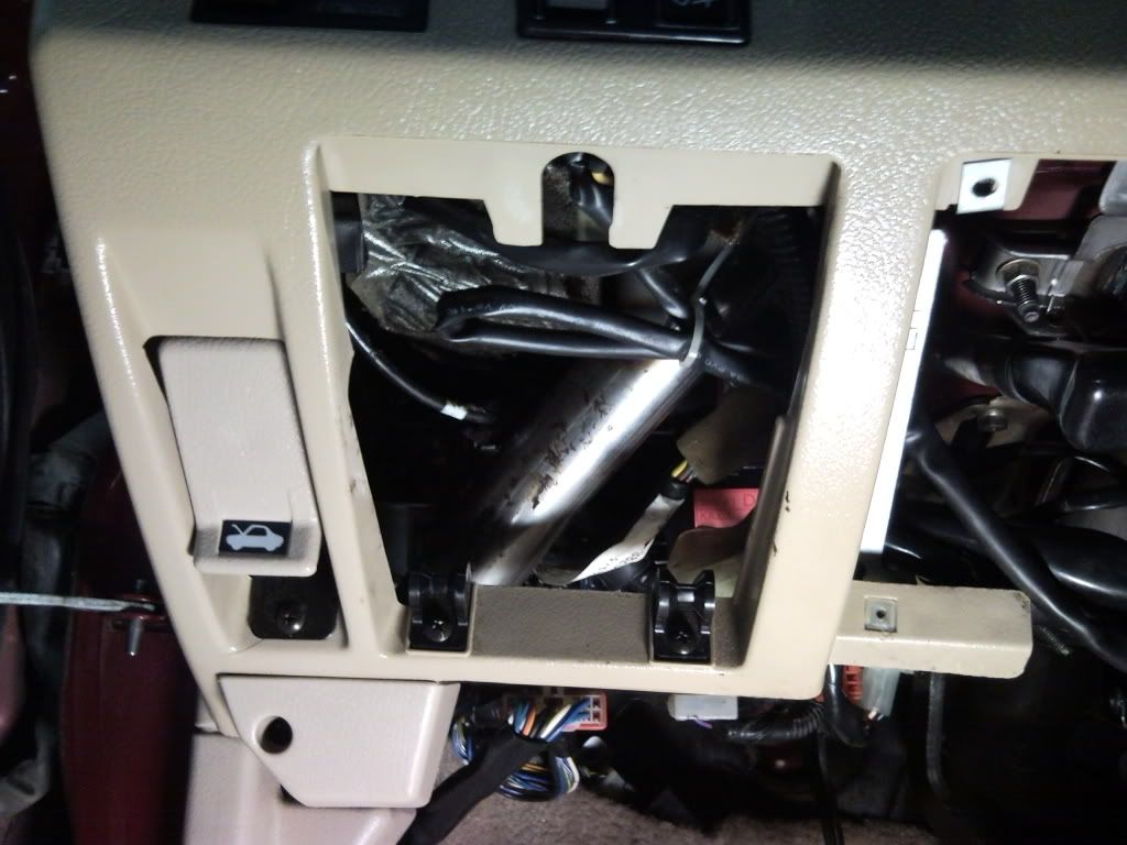

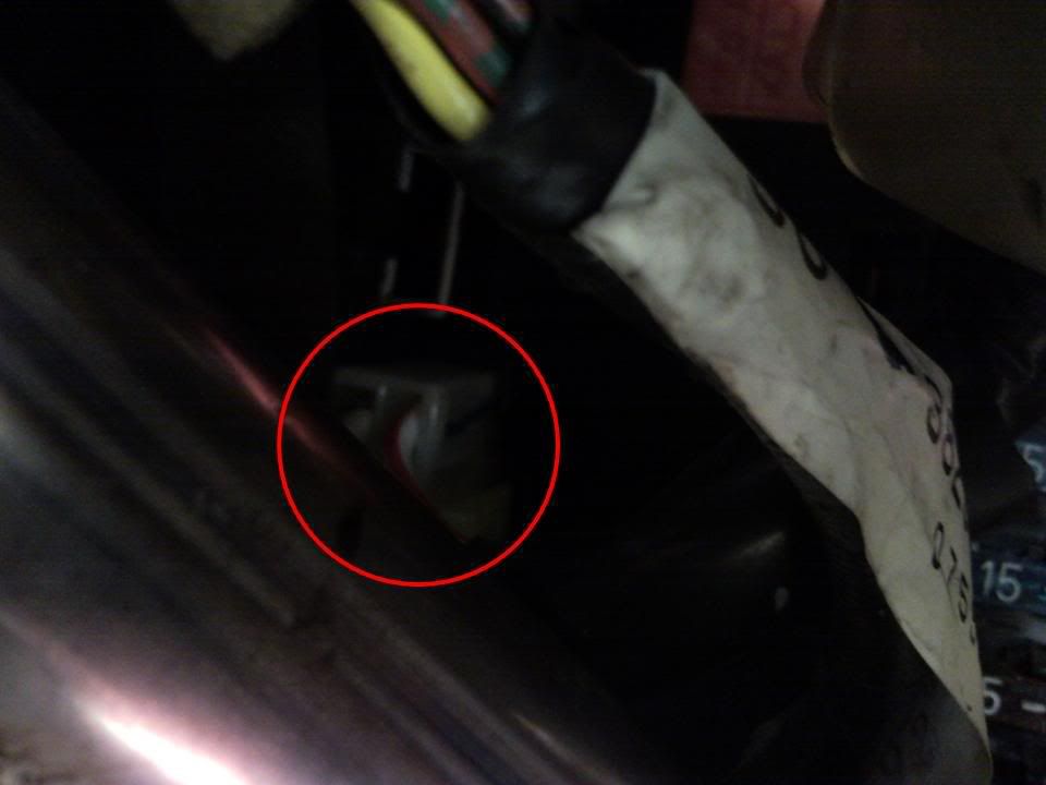

    The car runs!!! Woohoo!!! I wired everything up correctly. Back up lights work and the interlock is bypassed. I tracked the circuit from the battery and discovered that when I was swapping the pedal box, I didn't reconnect the ignition switch to the fuse box. If you contort yourself into a pretzel and look through this opening:
    You'll see a connector that looks like this.
    Jeepers. Can't imagine how I missed that one.
    The car starts and runs beautifully! Thanks to everyone for the great help.
