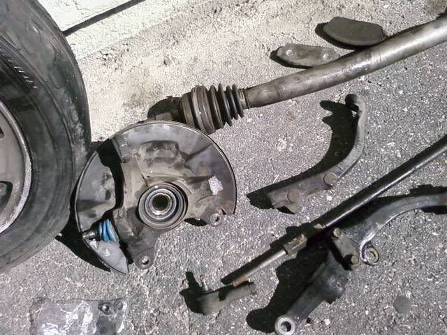

    you may have to replace the lower control arm, knuckle, radius rod and rear beam. Thats a bitch! When i did this to my 95 accord lx all this stuff except the knuckle i had to replace, and it was a pisser of a job.
    Re: Ran into a curb today, tire is badly bent :(
    its easy if you do it your self...i got all the parts off a junkyard.
    here is a pic of every thing i had to replace...
