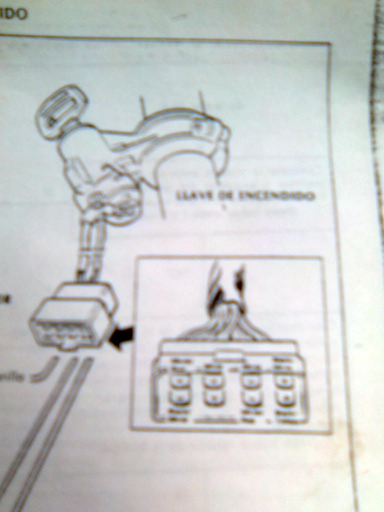

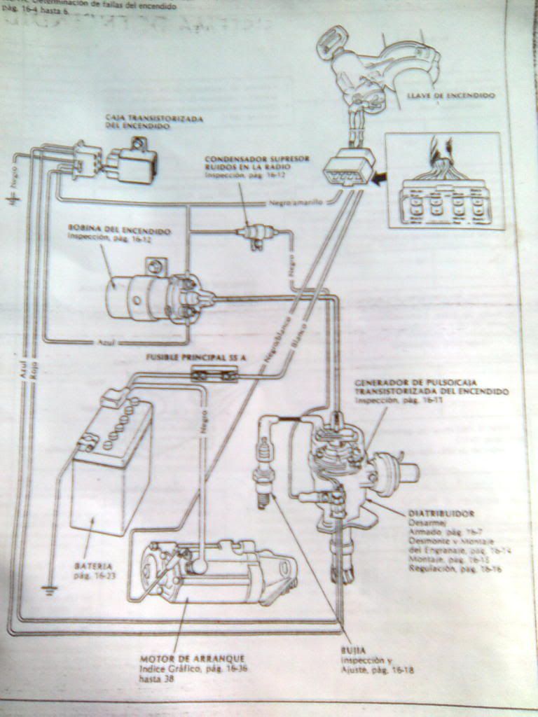

    To convert to electronic ignition just purchase the distributor, and ignition module, the wiring should be a easy task.
    Complete system:
    The ignition connector wires from left to right:
    UP: White/blue- White- White- Black/white
    DOWN: Black/white- NONE- White/red- Black/yellow

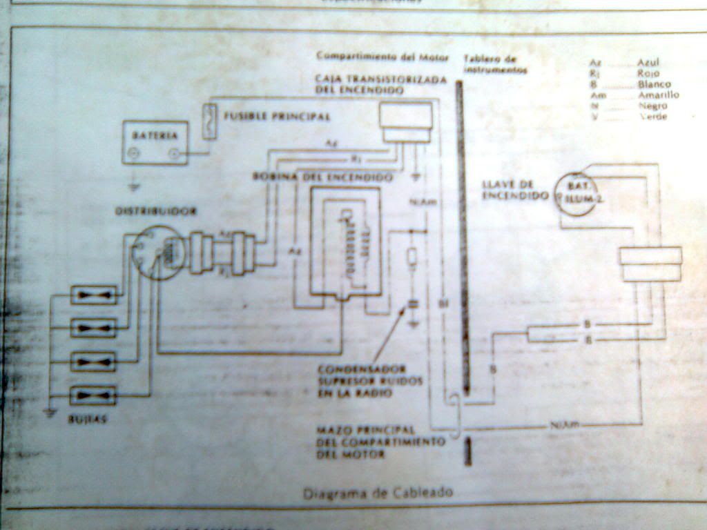

    The wiring diagram:

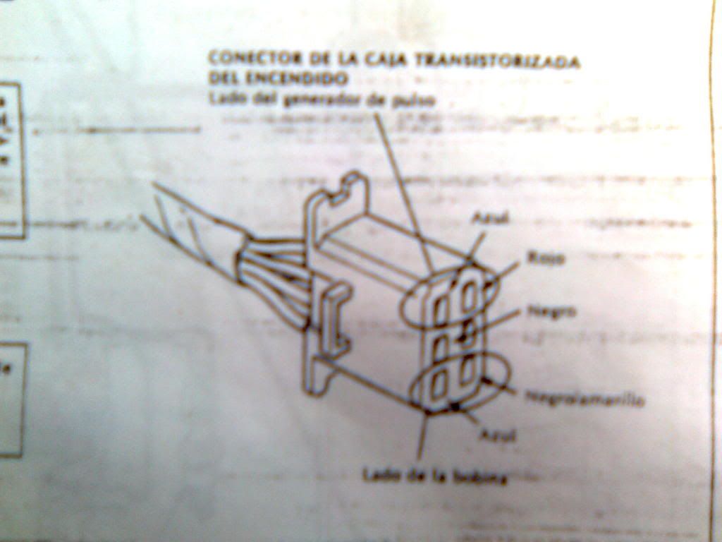

    The transistorized connector, left to right:
    UP (Pulse generator side): Blue- Red
    MIDDLE: Black- NONE
    DOWN (Ignition coil side): Blue- Black/yellow

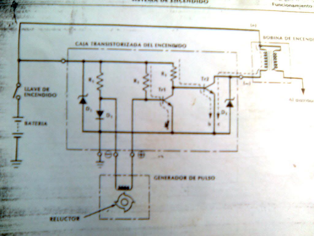

    The transistorized ignition module internal diagram (Very simple! )
    Well, thats all.

    not ruling it out, but since both distributors, fancy and classic flavours are full of red dust and wobble at the shaft, it would depend which is cheaper and more straightforward overall, which can be hard to judge!
    in favour of the electronic, i think i have the pulse generator and access to the loom it came from, and it would be adjustment-free and the distributor would likely last longer.
    as much as i'd like my life to be more pointless however, the current design has given pretty much trouble free operation and works without soldering.
    or taking the dash apart, i made a blood oath never to do that again after the heater debacle. :O
    79cord, if you could have a look at that '78 car at your convenience, see how worn the dizzy is, if the shaft has much play and how much they'd want for it, that'd be GRAND. there is nothing identifiable, much less useful, at the junkyards here, honda or otherwise.
    I'll go through those diagrams with MSPAINT and see if i can figure out what actually needs to be done. where might i get a good condition dizzy, and possibly a pulse box if mine's rooted? i'll call repco this morning but am preparing to be horrified by the price :O
