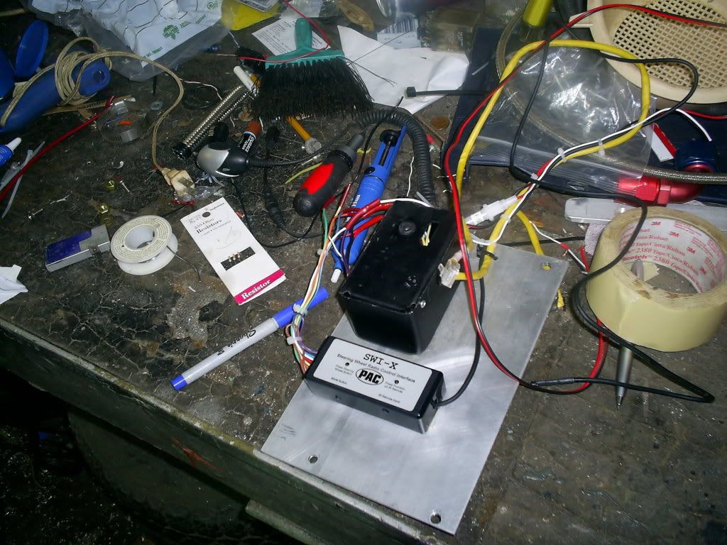

    I will try to take a picture later, of the PAC unit, I don't have an LCD on my camera, so i'll just have to aim and hope it comes out right, The box has a resistance in input, different resistances between it and ground mean different functions, I FINALLY got the relay box working, after messing with it for hours, I discovered the wiring diagram for the 98 civic mirror switch,was wrong. all of them I printed were wrong. I finally got a correct diagram. It's nice to hear all eight relays functioning. Basically, the relays switch a different resistor depending on which side of the button you push, and if it's set on left or right. plus three other functions. Now all i need to do is shrink the heat shrink, and hot glue the tops of the relays to protect from vibration. I'm looking for an oddball item though, anyone into old guitar amps? I'm looking for a knob that says either effect or reverb. I have a Z function on the radio,that has different preset EQ setups, I thought that might be a neat way to put in the button for it.

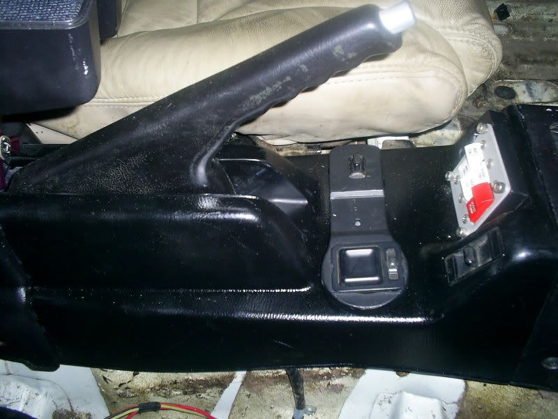

    I have a remote control, but the PAC unit learns the remote codes, I can operate all the basic radio functions and never even have to look at the radio face or the remote, that power mirror switch is built right into the center console, it's painted black so it blends right in, I have all the basic functions like volume up and down and scan search one one side of the control, I have a function button right in the raised part of the ebrake cover, on the front of it, you can't even see it unless you know it's there, on the other side I have the band button, the Z button is where the old cigarette lighter used to be, and the mute button is in the piece that fills in the old ashtray area. everything is intuitive as far as the controls, really easy to remember. the other four functions will control the XM radio as far as scan etc. everything right under my hand. I don't use cd's in the car anymore at all, I have the ipod, i have a mount for it that attaches to the side of the console,

    I'm having some programming issues, I'll call them tomorrow, but here's the setup. it mounts upside down to the bar that runs across the hatch,under the floor panel in the back.
    Re: answer to the problems of hooking the sei wheel with stereo controls to aftermark
    It's not accepting some control inputs as far as programming , I tested the setup without the unit and everything falls within their range of resistance, There are multiple versions you can load so I will call them tomorrow.

    I Finally figured it out, even after calling tech support six times, they couldn't figure it out, I had to add an extra 330 ohm resistor in line with the input to the box. each relay switches a different resistor, but for some reason It kept rejecting the input, once i added the resistor it started working.
    It finally programmed after about 30 tries, it's very ticky while programming, i would get to the last two functions and it kept timing out, I still need to install the additional buttons, i programmed a resistor for each button, one terminal on each push button goes to ground, the others each get a resistor that all tie together back to the box. each control input gets a different resistance. thats how the box knows what function you want. I programmed in track/search up down, volume up/down/ play pause/ function/band/mute/scan , I think there was a remote control available for my XM unit, I'm not sure. I would like to be able to scan through my favorite programmed stations by using the unused two functions on the mirror switch. the main reason for all the trouble was I hate fumbling with a remote control, especially in a five speed, now i have the most used functions right at fingertip reach.

    here's the main stereo controls, the mirror switch on the center console.
