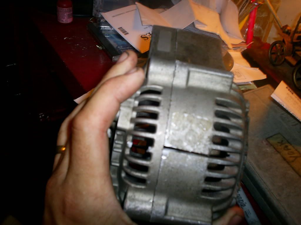

    All I had to do was put a 4 inch slice in the case between slots, cut the stator in half, it's nothing to put a weld back on the cut and smooth it out. it's easy, i'll press the rotor off tomorrow.

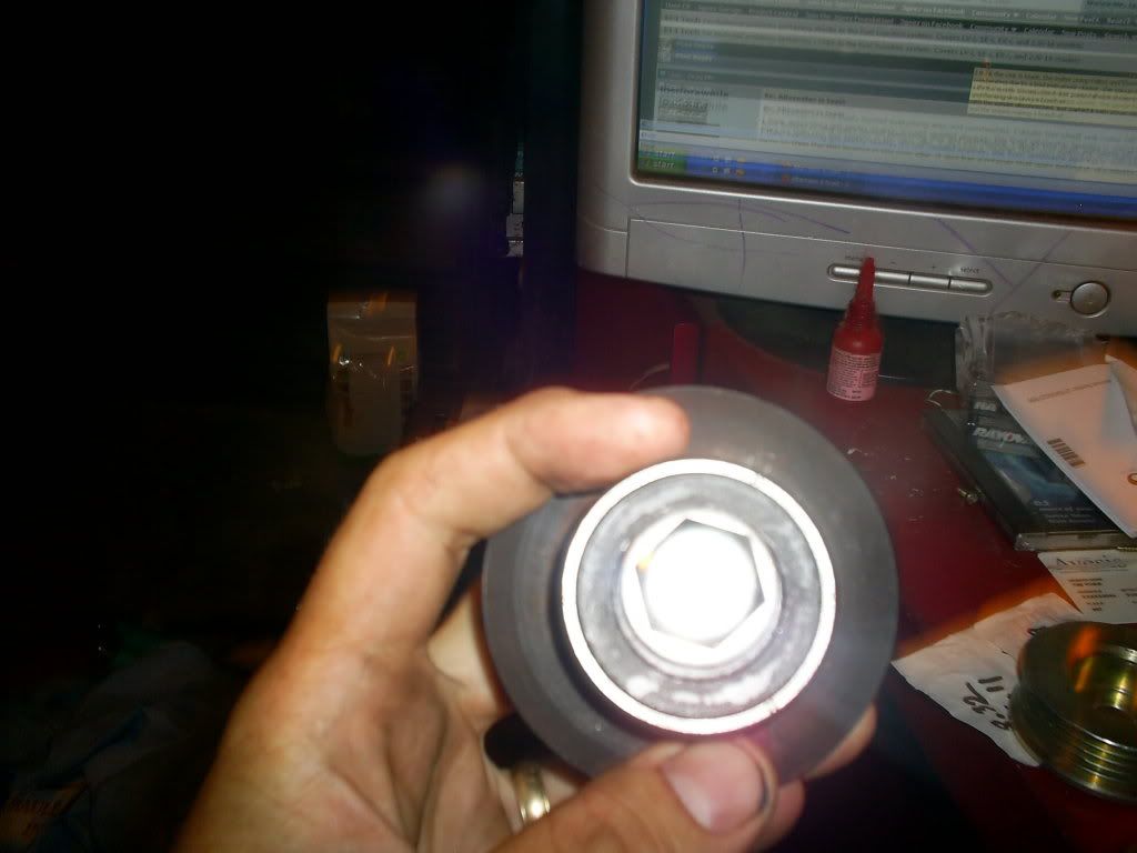

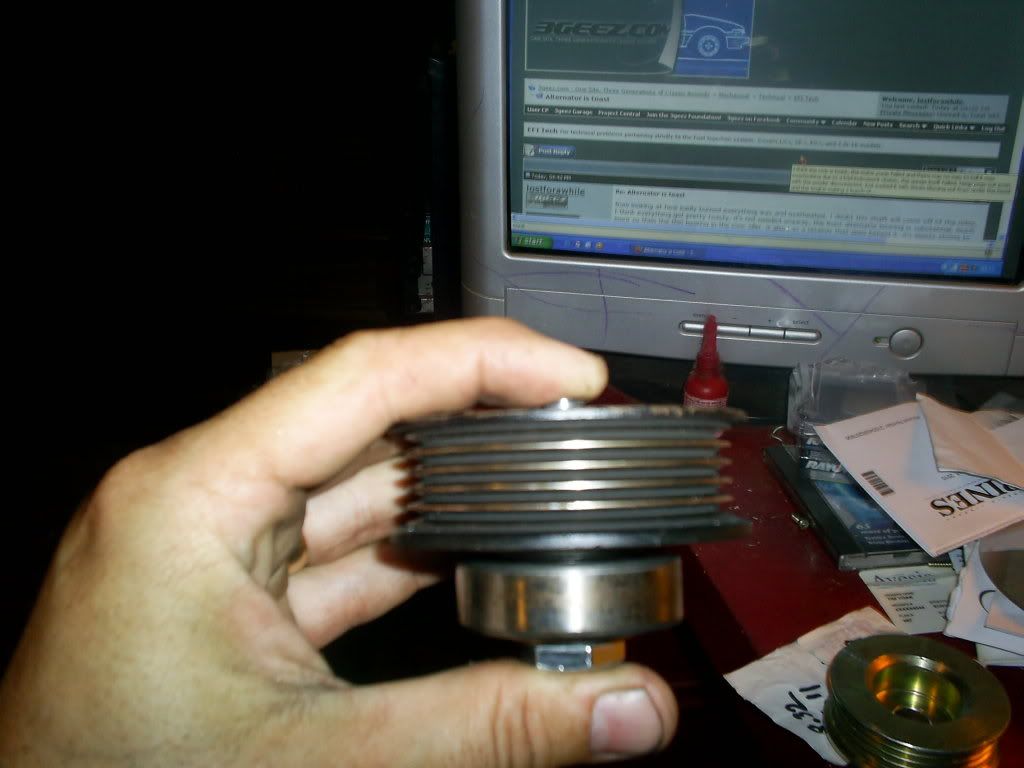

    from looking at how badly burned everything was and overheated, I doubt this shaft will come off of the rotor, I think everything got pretty toasty, it's not needed anyway, the front alternator bearing is substantial, much more so then the thin bearing in the civic idler, it also has a retainer that goes behind it, it's plenty strong to act as a water pump idler, i have an axle bolt with threads on one end, it's a shoulder bolt, all i have to do is sleeve it where it goes through the bearing and pulley, I can make one sleeve and press it on the 1/2 inch axle bolt and change the diameter to 15MM

    this is all I had to cut, this is a simple TIG weld to put the case back together,
    you can see the size of the front bearing, it also has a retainer plate behind it. I just used an empty alternator case, because then I know the water pump belt is perfectly aligned.
