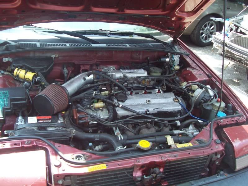

    Re: mods for stock LX-i motor?
    The 88 and 89 LXi and SEi in the states have the 4-2-1 manifold.
    Sweet, that's good to know. That means my 89 should have one.
    I got the new intake on the car today....
