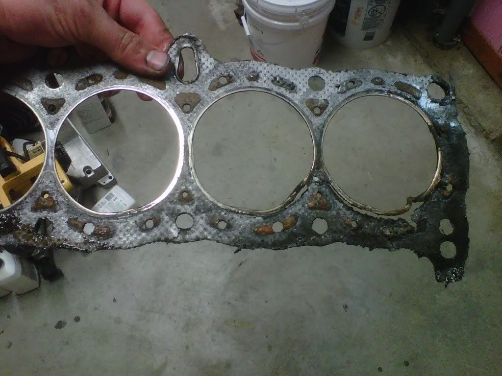

    I recently blew a head gasket. Worse gasket I've ever seen. 3 of the cylinders were either blown or about to blow, and cylinder #1's steel ring was crimped and coated with carbon. I'll post pics later.
    I broke the plastic tubing that feeds my pcv valve, it was all hard and brittle. I'm not sure what the best fix for this would be, any ideas would definitely be appreciated. The tubing looks specialized, and the barbed/press/slip sorta fitting they use doesn't seem easy to adapt to.
    I'll be posting more tomorrow including pics of the head gasket

    Beautiful Gasket if I ever saw one
    I don't even know how the car ran. Or how it ran so well, I parked it, left it there for 6 hours, when I started it back up, it was only running on 3 cylinders. Up to that point it showed no symptoms. No smoke or condensation in the exhaust, No bubbles in the Radiator, Ran perfect. It was literally shooting coolant out from between the head and block. =S It looks like cylinder #1 got the worst of it, but cylinder #2 and #3 weren't too far behind, they had some warpage to their steel rings as well.
