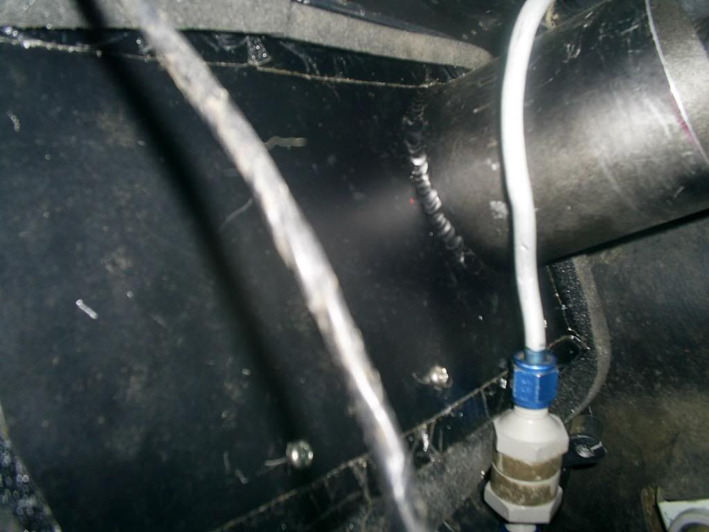

    you need a thicker piece for the blower end, it will fit into the opening on the blower, then you put screws through the edges to secure it, I tried the plastic and it just wouldn't work. I can send you a short piece of the round silicone duct if you need it, just paypal some shipping and i'll get it out to you, I know I have a couple of short sections of aluminum tube that it fits over also, maby some wood pieces and a hole saw, plus some epoxy?
    Re: URGENT! Need a DX AC Delete box!
    this is the piece at the blower, you can see how it fits inside of the end of the blower, I made mine from a special plastic, but you could use wood,
    this is the heater core end, I made a plate with a piece of aluminum tig welded to it, I think it has to sit on top of the surface, if I remember right , you can use wood again.
