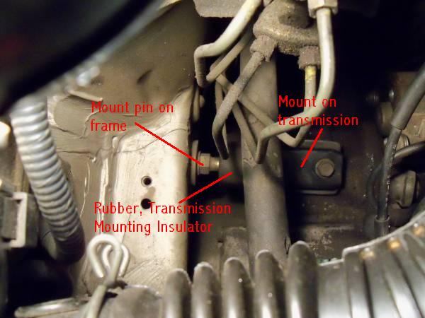

    Trying to figure out where this part goes b/c my car doesn't have one (a/t to m/t swap)
    parts # 14,15,&16
    Any got a pic? Thanks!

    thats the A/T mount, I tossed mine when I did my swap.
    M/T does not use that mount

    Quote Originally Posted by POS carb View Post
    parts # 14,15,&16
    Here are the pics of 14, 15 and 16 on my 88 LXi automatic. #16 is the "Rubber, Transmission Mounting insulator". Part# 50852-SE0-A01. Mine was torn and I replaced it. It is on the passenger side looking down, below the prop valve. Again this in on a automatic transmission.
