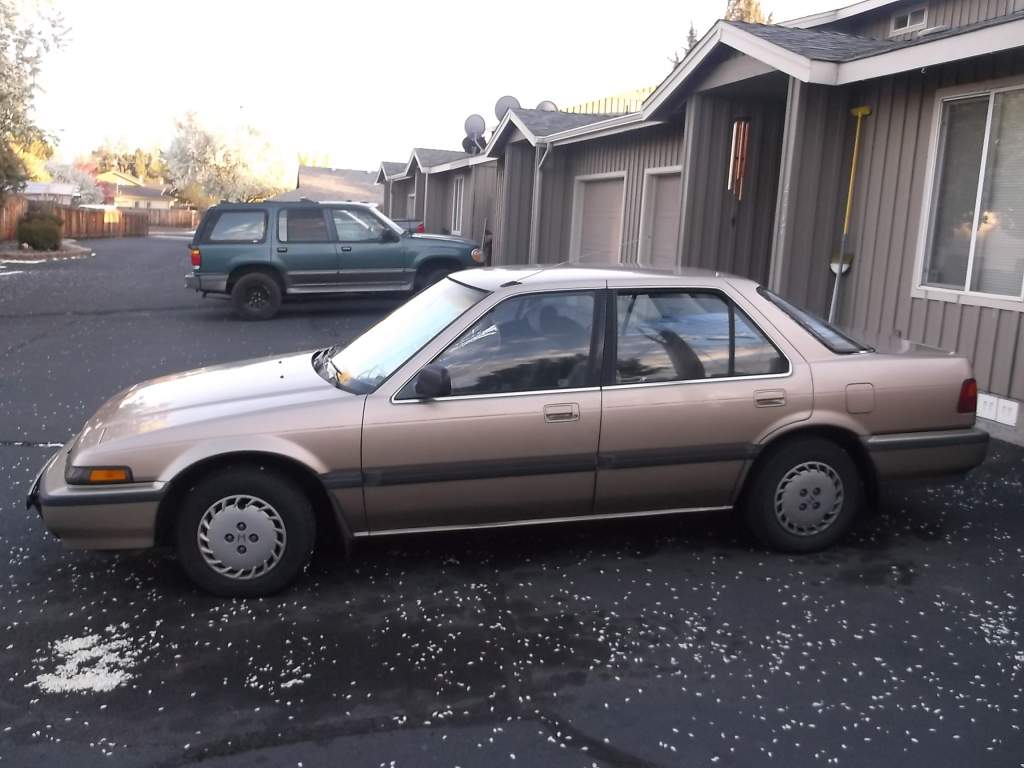

    1988 Honda Accord LX
    Redmond, Oregon
    2
    Cool 88 Accord LX - still cruising, with some transmisison issues......
    Hi all, newbie here. I have an 88 Honda Accord LX (original gold paint, we call her 'Goldie'). Been a good little car, but some months back I blew out the 5th gear while on the highway, it just popped out and I resumed into 4th gear for highway driving since then, and have had a mild to moderate grinding sound while shifting in the lower gears more particularly, as it fades out while in higher gears. I just never bothered to even try to use 5th gear again, and have had the transmission fluid changed a few times since then to clean out any possible metal shreds or grime, - my mechanic put in honda MTF each time. A rebuilt transmission plus labor looks like $1500 - 2,000, and while I love my Honda, I think i'll just do the best to nurse her along til she retires herself, and plan to get a newer model FIT, love the silver color and black trim ones (maybe a 2008 -2010 model, gotta shop around).
    Anyways,...appreciate any help, suggestions and comments on the transmission. Im still just under 200,000 mi. - not sure if getting another transmission fluid change sooner will help the transmission flow smoother or not, or just change it at recommended interval. Otherwise, shes running ok (not the most optimal however). Last report by mechanic was some oil dripping out of timing cover, carb is worn out somewhat, power steering rack is torn open. She does have slow oil leaks, and the engine was a bit too dirty/oily for them to do a free steam clean (so they said). So, shes has put in her time so to speak. I've been putting 10w30 in her, sometimes synthetic blend or reg. oil. Have added Hyperlube and Lucas oil stabilizer with oil occasionally, if that helps any. Thanks for any help

    u can swap out 5th gear without taking out the transmission u can remove the black case on the end of the trans and change 5th gear

    Quote Originally Posted by rushell View Post
    Thanks for the tip, not sure my mechanic knows about that, as they just referred me over to get a whole new transmission, so got a quote for near 2 grand for putting a rebuilt in. Interesting detail, - if i was more into working on car myself, i'd get into that, but prefer someone who knows what they're doing to keep it in best running condition most inexpensively.

    Yes your 5th gear can be serviced without removing the tranny but the real problem is that you ran low on tranny fluid for it to go out. It's probably due to the shifter rod seal located on the back bottom of the tranny. That seal can only be replaced by taking the whole transmission apart.
    I'd just check the tranny level every so often.
