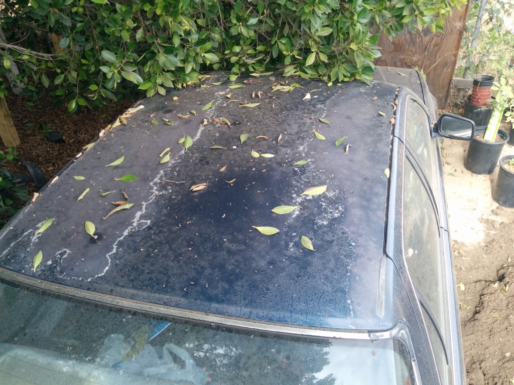

- I feel like a complete idiot asking this, but how do I find the type of engine I have...someone gave me a 5spd '87 Accord LX Sedan and I want to know as much about it before I start work on the car.
- What are the best idiot-proof bolt-on upgrades for performance and handling? I am going to be replacing the broken clutch with a mechanic friend (I know nothing about this car)...are there any upgrades I can do while that area is all disassembled?
- What do I do for exterior looks? What are the best cheap rims for this deep blue color? Also, could I have your guys opinions on plasti-dipping the roof black? Maybe the trunk and back bumper as well?
You can find out what engine you have by looking for the engine code stamp like this http://asia.vtec.net/topics/engcode1.jpg
Judging by the looks of the picture I'd say your car has been sitting for a while. The best upgrade for you right now would be a tune up. Change the oil, spark plugs....
For cheap rims I'd say buy used rims off of Craigslist. Plasti dipping the roof wouldn't be a bad idea. Looks like the roof gotten eaten up by the sun pretty badly.
