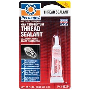

    Good write up. Definitely should be a sticky. The only thing is that the oil sender is a standard pipe taper fitting. You should put some liquid gasket on it and tighten to 13 ft-lbs. The o-ring is probably not doing any good.
    Re: Oil Filter Base Mount O- Ring/Gasket Replacement EFI
    it's 1/8-BSPT not standard, standard is 1/8 NPT, if you screw in a standard thread it will damage the threads. they make adapters if you want to add a line for an oil pressure gauge, summit, jegs, etc all carry it, or you can get it much cheaper from some place like MSC. you need a 1/8 BSPT male to 1/8 NPT female adapter
    Well if we're going to get technical, then per the Honda manual, it's "British Standard Pipe Taper."
    The point is that you should use pipe dope or Teflon tape.
    permatex liquid pipe thread sealer, comes in the little white tube, best stuff on earth, it's the only thing the FAA allows to be used on airplanes. I wouldn't use teflon tape on anything in the car, it comes apart eventually from oil. It's actually banned for use on aircraft because the little pieces of teflon tape end up in the oil system, plus it had a tendency to leak

    this is the stuff I was talking about, throw your teflon tape in the trash. a little of this goes a long way.

    Yes I agree that is very good stuff.
