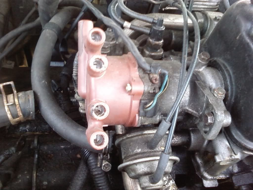

    Ok I am surfin the JY and am finding three different distributors. I really like the metal vac advance set up but I notice they do not have a the metal module on the side like the plastic vac advance dizzys have. What is the diff dizz??
    Do they have more movement of the vacuum actuator?
    [IMG][/IMG]

    thats the ignitor missing right? that thing looks weird is it on a carb or fi 3g?

    Alot of the Factory Dizzy's had Metal Vacuum Advance, then people broken them off and replaced them with plastic
    That looks to be a Hitachi distributor

    Nothing is 'missing' it just does not use one, I saw one then another and another. But yes the shiny thing is not present on that one.

    There are two distributors. The TEC and the Hitachi. Been like that since the 1geez. Don't know why there are two, and there seems to be no rhyme or reason to which ones are on which cars as far as I can tell. I also believe there may be a difference for automatic and manual, but I'm not sure why. More advance when in "D" or something when you're not moving to make up for the load.

    I've never seen any EFI Dizzy's with the metal Vac Advance, But I've seen alot Carb metal vac advance ones in the JY
    Here is a TEC Carb Dizzy with the metal vac advance:

    What difference does it make what the advance canister material is? The diaphragms will wear out long before the plastic housing, anyway. But, as they have already said you have a carb engine distributor there, not FI.

    The Hitachi has the ignitor system mounted internally and the TEC has it external. I've ran both on my LX with no mods
