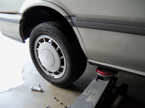

First jack up rear of the car and remove the phillips head screws from the rear bumper directly behind the rear wheel. If you have the mud flaps on, the rear wheel may have to come off to get at the screws. I had no mud flaps, so I used a short stubby phillips head screwdriver to get to the screws with the tire on.
