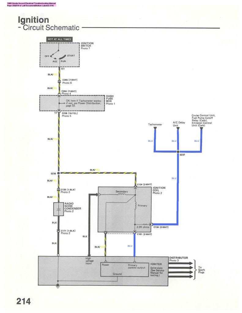

As I understand from schematics, the Blk/Yl wire coming off the ignition switch runs to splice to the coil, and to the Radio Frequency Inhibitor. From the RFI, it grounds to the ignitor/dizzy, then frame. This right for my 86' lxi??

This Is The 86-89' A-Series Prelude Power Distribution Pic. (From 86'-89' Prelude Manual{1 of 2}Page 656 of 705 total.)
This Is The 89' Accord Power Distribution From The 89' Accord Electrical Troubleshooting Guide.(Page 223 of 319 total)
Which Diagram Would Be Best Fitting For An 86' Accord lxi? The black/yellow wire shorted somewhere between the ignition switch and the coil/dizzy. I NEED to know which diagram is best explanatory. The Fact that both are for the a-series and on the prelude, the blk/yel wire runs/splices to the coil/RFI condenser and igniter vs. the accord showing only the coil/RFI condenser, then blk/yel connects to the igniter via seperate connection from coil. I'm quite confused. someone help please?

different distributors is what that looks like to me, and what do you mean the B/Y wire is shorted? do you mean open, as in not completing circuit?
Shorting means power going to ground and popping fuses, setting fires, melting shit etc
Open means there is something not getting power as it should.ie break in the wire or connection
The upper diagram (canadian model) and the bottom one from the '89 are fundamentally the same. The only difference between the middle diagram and the other two are that there is an igniter module external to the distributor. If you were to imagine taking the igniter module from the diagram, and placing it and it's wiring "inside" the distributor, you'd end up with the other two drawings.
Aren't there more than just the ignition circuits running off of that blk/y wire? Just wondering.
Yes. It is open. Please excuse my reference as i have absolutely no electronics/electrical education/knowledge.
No power to the coil/dizzy etc. Running a red wire with alligator clips from the ignition switch blk/yel connection to the blk/yel coil connection solves this power problem. It'd probably help a ton if i knew how to use a multimeter/voltmeter, or even had one for that matter. All i've ever used is one of those connection lights you touch to a wire and ground the other wire that comes out of the light, and it'll light if you have power.
More connections to the blk/yel wire? All I've found are these pages I've posted. Could the other connections connect to another colored power wire from the ignition?

Shouldn't I have voltage coming out of my Radio Frequency Condenser? It does have voltage on the way in. Just none out. But...It is supposed to be the ground. I'm new with a multi-meter. Bear with me. A little help though?
