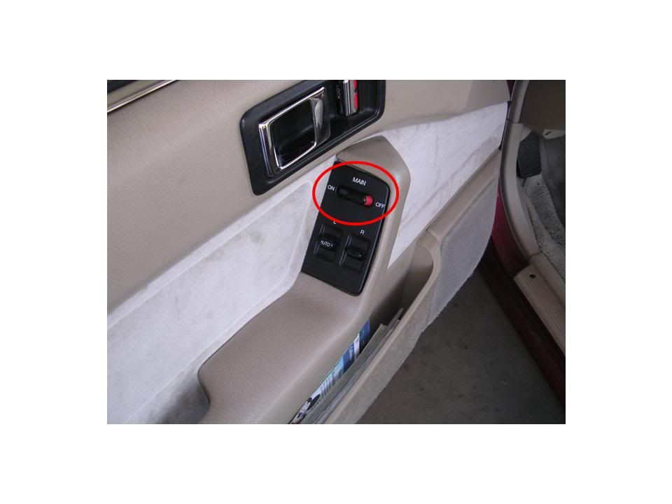

    My passenger window up and quit on me. No warning, no strange noises, just quit. I tried jiggling both buttons, slapping the door and still nothing. I tore apart the passenger door with my trusty multimeter in hand. Everything checked out, so I shorted the window motor with jumper wires and it worked like always. I figured it was a bad switch, so I tested the switch, but it worked just fine. I then tore apart the driver's door, checking as I went. I was testing the driver door switch when I realized that the button to disable the windows had been switched off. I switched it back on and the window started working just like it had.
    That's right, I tore apart two working doors because I had flipped the disable switch accidentally.

    LOL snooz that blows! I was thinking control box until you said that.
