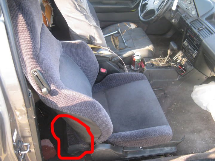

    I left the two bolts out of each seat, they seemed sturdy enough.
    And what I mean by the bucket sticking out is circled in the picture below.
    See how it sticks out behind the back of the seat?
    It should be flush with the back of the seat.
    I love my 3Gee so much!
