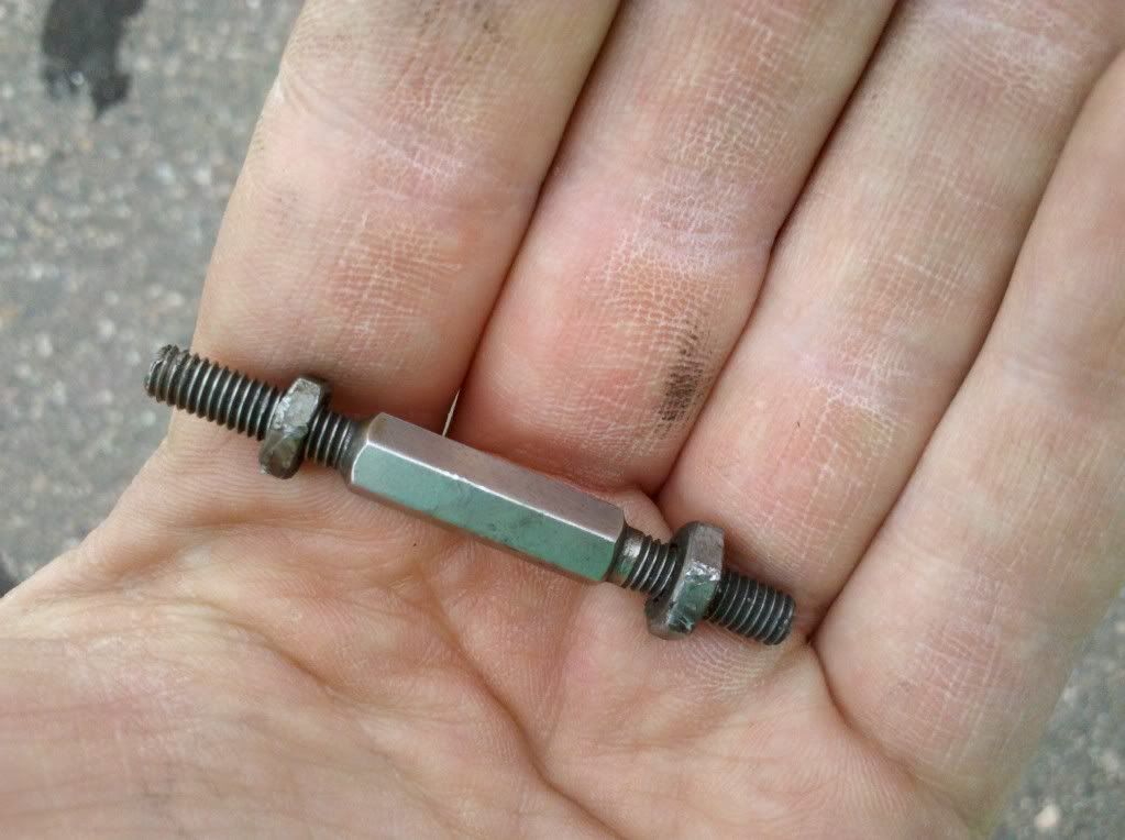

    Right now my car isn't running to great as of last night! I noticed that my car was running a little rougher and rougher, so i had this idea that i'd set my afr to 11.5-12 on the one cylinder (since i'm really only measuring one cylinder) to and then shut the car off and turn all the other idle mixture screws to the same as the ideal running cylinder. 2 and 1/4 turns out is where it is now. I set all the other mixture screws to the same and fired it up... I had a pretty good idle, but i couldn't really get it to idle down from 11rpm no matter how much i tried. I thought that was kinda weird but i was in crunch time trying to meet up for a local cruise in. The partial wasn't too hot. it was spotty at best, which was weird because it was running so well before all the craziness. Also I noticed i was super rich (11.0-11.5) under acceleration until i got to about 6.5rpm, then went pretty lean! It drove decent, and mid range felt good, but top end was gone and my partial wasn't so hot.
    When i got to the local cruise in i tried to adjust my idles while i was there, figured i'd turn them just a 1/4 richer... partial was even worse, plus off throttle i was getting lots more back fire, which is abnormal, because before the car was pretty smooth especially when i wasn't coming off of a full throttle. And whilst i was adjusted the idle mixture screws and changing things around, i fired the car up again and notice that now i have a weird squeak that pulses with the rpm... I def sounds like its one of the carbies but i can't figure out which one. So then i checked my carb sync, and i found that i had a steady 3.5in/mg on cylinder 1,2 but 7-10 (pulsing with the squeak) on both cylinders 3,4. Today i'm leaning towards a vacuum leak but really haven't had time to look at it... just sucks!

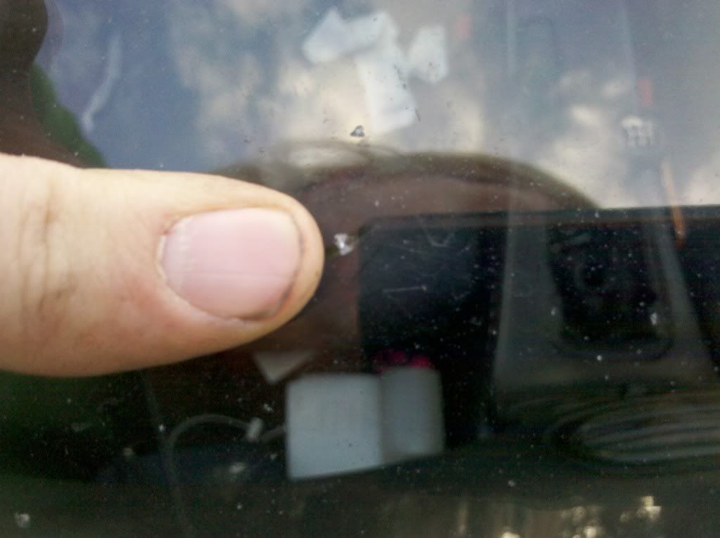

    alright guys! quick update before class! Well the other night was frustrating... i was trying to get it running again last night, and having a bear of a time trying to keep it idling. On my carb linkage i didn't have an adjustable screw between the main carb and the slave carb. So the other night i swapped in an adjustable one, which is when i realized that putting an adjustable one in, just gets in the way of the linkage for the throttle, ARGGG.. So last night i took the linkage apart and swapped the slave one for the main one, so now the passenger side carb has the linkage mounted on the far outside (pass) of the carby. that left me plently of room in the middle to get the adjustaable screw in there. I then synced the carbs up for off AND on throttle. before i was just adjusting the idle on both the carbs, syncing them that way, just assuming that the fixed screw was perfect! WRONG! this whole time my two carbies were synced at idle and were slightly off ON throttle. Also after all the "trying to get it to run" my 2 and 3rd cylinders were pretty much useless, plenty of suction, but no firing. bought new plugs, and boom, much better. Tuned it, synced it and man does it even feel better! Time for bigger mains, again! And some computer time. ordered some 55F9 idles and some 50 accel pumps last night, as well as a anti vib kit last night. should help keep it all together rather than vibrate out of adjustment.
    then i went driving to class, driving seperate from my gf, and this happened...
    throttle screw fell out and...
    hit the windshield of my del sol (that my gf was driving)
    Got lucky and found it in the road after having nothing but idle... O snap 4 more minutes to class!

    your not kidding! I just can't believe that when i was fucking around I happened to be in front of her (least i remind you she is driving my 400+whp car) and that piece came off the prelude and hit the upper part of the lowered Del Sol windsheild, and to make it even better, I actually found this little diddy in the ROAD! I feel so lucky... She remembered well enough were the hit on the windsheild was and it was right were she thought it was. Some of you might have noticed but that is a left hand / right hand thread piece which would be nearly impossible to find anywhere local. without that piece i would have had to walk to school and figure something ELSE out... Shame i guess i would have to drive the ALWAYS reliable white prelude.
