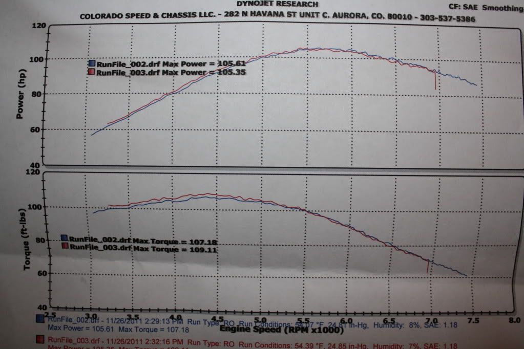

So of course I put up some pretty dissapointing numbers...
*DISCLAIMER all these numbers are numbers to the wheels at 5300ft above sea level. Keep in mind that for every 1000 ft above sea level, you experience roughly a 3% power loss. These numbers are also on a DynoJet.DISCLAIMER END*
Of the two runs, I made 105.61whp @ 5600rpm and 109.11lbs of torque @ 4500rpm...
Yes, that is the disappointing run for my car... White smoke out the back, carbs screaming, and somehow still I got alot of people telling me how impressed they were... Weird. I did data logged all three runs with my megajolt and personally watched my afr, and video'd the runs... This is the power you can expect to run on a potentially blown head gasket with similiar mods
*edit, figuring you have about a 16% alitude loss, and a conservative 13% drivetrain loss, I'm making roughly 138bhp, which is still a 38hp increase over stock...*

Dyno Sheet...
