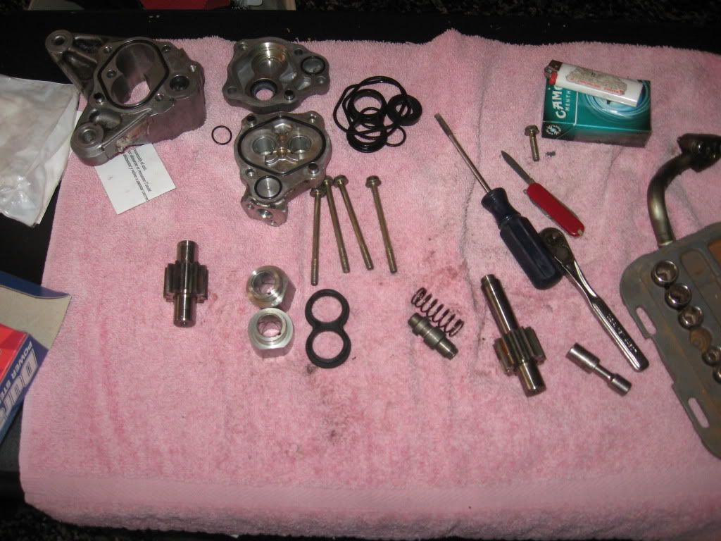

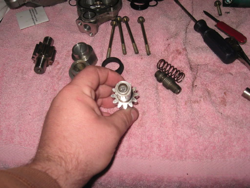

    Got the power steering pump rebuild started...
    I will have to drill and tap the input shaft,
    Awesome pink towel right...
