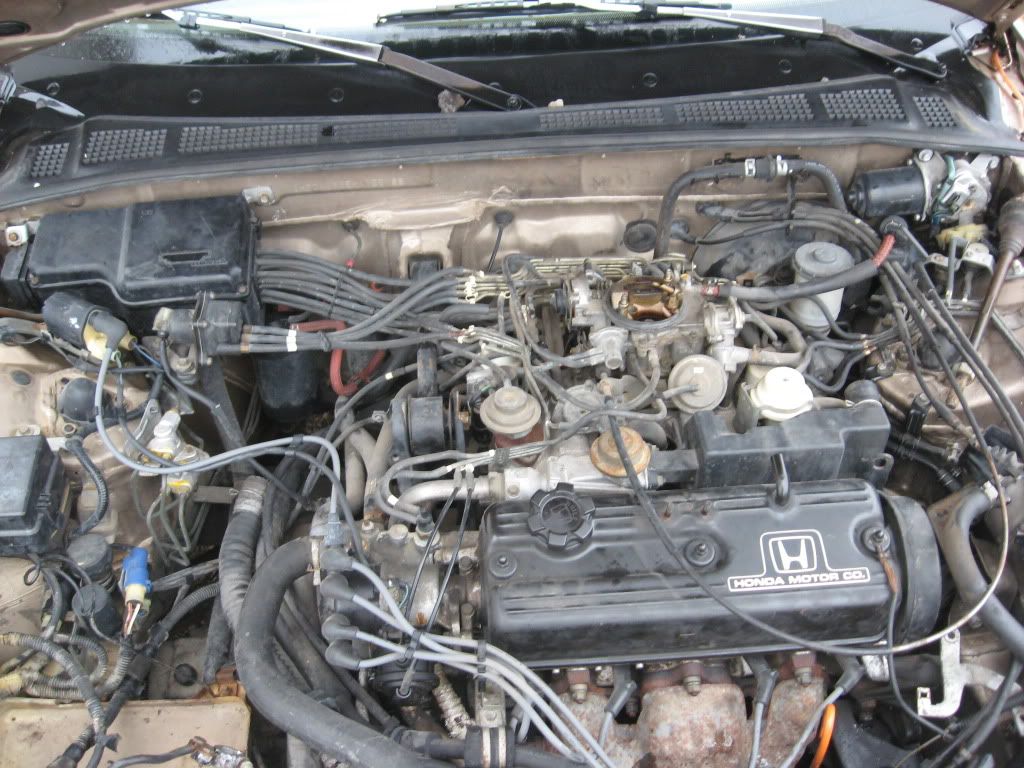

    well I got that water pump in, kinda got whipped by the tensioner tho...
    fixed every vacuum leak I could readily see...
    Finally got to take it out for a spin around the block its running great! still idling a little high about 1500(park) and found out that the previous owner had broken a bolt in the T-stat housing and their fix was JB weld, fun fun...

    Sweet! Your in the $300 club!
    Check your throttle cable and see if it's a little tight.
    Is it completely warmed up and idle'n at 1500? I think your t stat can affect the idle even on the carb'd cars.
    Search in carb tech for idle issues. Lot's of info in there.

    i bought mine with 102K 1988 accord lx 4dr auto!! Shes clean, but runs like shit haha im givin her a tune up and will go from there, might even rebuild the carb if idle run quality doesnt improve, make sure you replace PCV valve, breather element, and both fuel filters before moving onto diagnosing carb issues!
