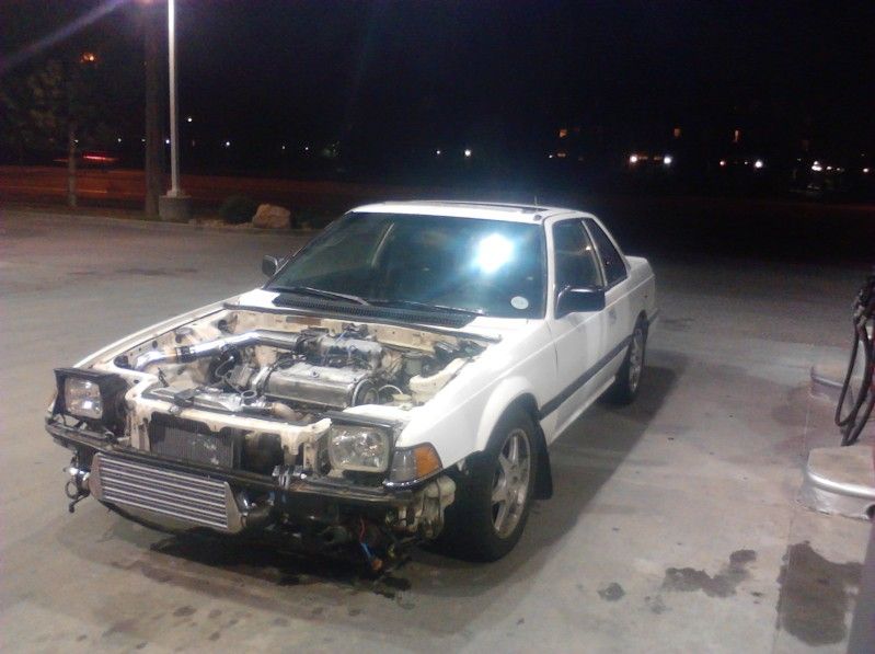

    Re: gfrg88's Prelude build..
    Fuck that skank KARMA!!!!
    Well, the whole no oil thing was an April fools joke. Have vids of the start up of the car.. took her out for a cruise (on my way to meet up with Ryan), and the fucker decided to start spitting oil everywhere :'(
    Oil feed line was hitting manifold, burned a pin hole through. got oil all over car. I'm super glad I didn't have hood on, or else I probably would have not caught it in time. Replacing feed line tonight, and will have vids and pics up
    -Gio
    weeeee!!!! Hit's full 5 pounds of boost by 4k rpms!!!! Time to turn up the boost!!!! Did a gangster one wheeled wonder all of 1st and 2nd.. dsm 450s are already at 75% duty cycle with the corn fuel only at 5psi
    12.5-12.8.
    Threw on the 1000s. Had quite fun trying to idle them, and shooting big flames out the 3.5" downpipe was awesome!! Turned the boost up to 8, and she pulled amazing! Saw full 8psi at 4500 rpms. she pulls awesome!!
    Raising boost tonight..
    Got some pics
    Manifold finished up..
    IMG_3326 by gfrg88, on Flickr
    New, to me, wastegate..
    IMG_3363 by gfrg88, on Flickr
    fluxcored downpipe ftw..
    IMG_3370 by gfrg88, on Flickr
    Never doing wire tuck again..
    IMG_3325 by gfrg88, on Flickr
    New mounts for radiator..
    IMG_3328 by gfrg88, on Flickr
    IMG_3329 by gfrg88, on Flickr
    IMG_3360 by gfrg88, on Flickr
    Everything buttoned up :noel:
    IMG_3362 by gfrg88, on Flickr
    Vids soon. and dyno sheets to follow
