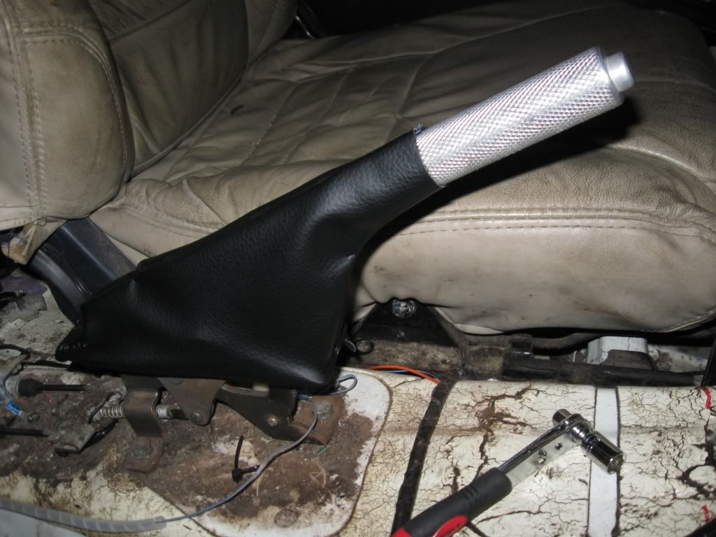

    I finally got around to making my ebrake handle, tomorrow the boot

    it's pretty much permanent, as it's driven on lol, better then the original thats for sure, I'm working on the boot tomorrow

    it's aluminum

    this is the piece that will form the base for the boot, it still needs finishing up as I was rough fitting it, this does the same thing as the bottom of the rubber boot, and fits over the steel of the handle itself, I need to make a couple of brackets to anchor it to the handle, the boot goes over the handle and the console cover isn't directly connected to it, I was going to make the leather boot myself, but a friend of mine is offering to make it for me

    thats my 1901 three headed knurling tool, instead of doing it strictly by hand like I usually do, I set it up with the lowest feed speed possible and a very low RPM on the lathe, and let the machine feed it, it took about 30 minutes to do that knurl

    Ok I'm almost done with the boot, lots of tiny stitches later, I have to make the bezel for the boot, then it slides down the handle, once I put the bezel on, then I can glue the leather to the bottom plate. the plate attaches with a couple of brackets,directly to the E brake arm itself
    this is the master pattern, basically you cover it with masking tape, then split the tape with a razor blade, and lay it out on paper, anything that doesn't lay flat, gets split, this becomes your pattern for the material
    the pattern
    this is the bottom plate
