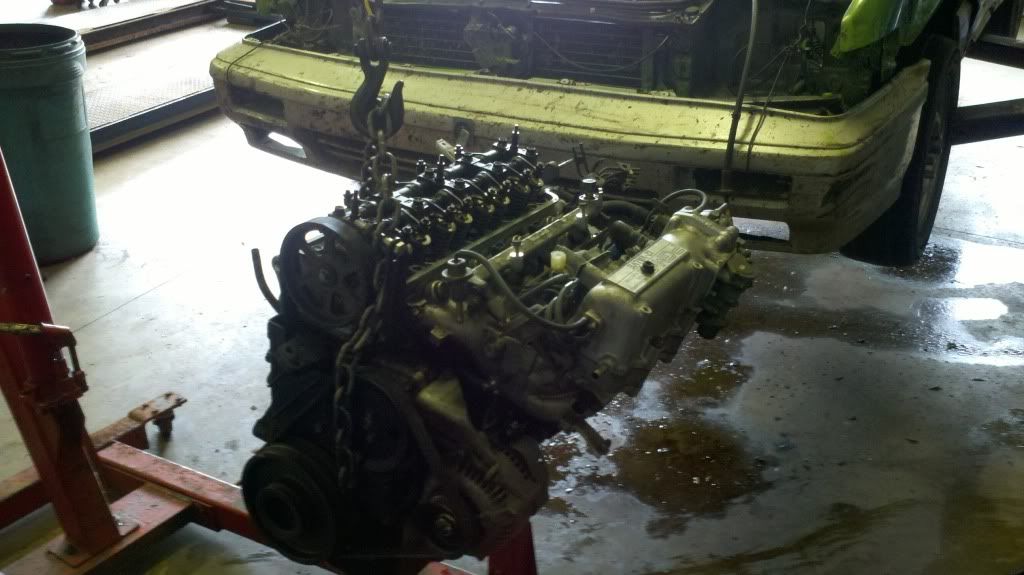

    I got the head on the block and everything else mounted except the trans. It looks good, anyone have any tips on adjusting the valves on a reground cam?
    Also everything i do has to look stock, im kinda cheating with the cam lol.

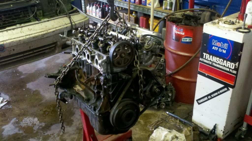

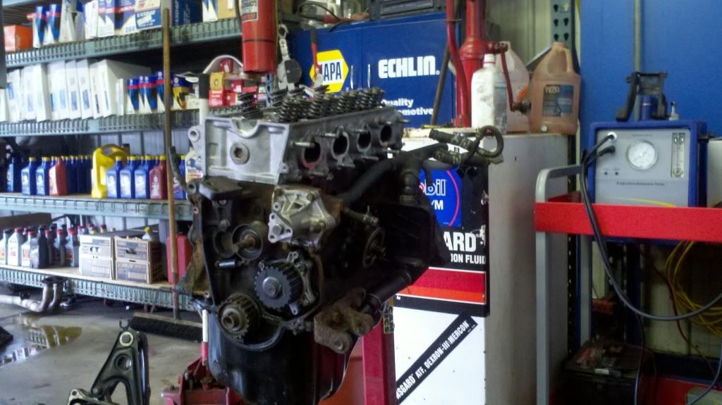

    I finished up installing the engine on Saturday. I had a few things to do like, finish making my solid motor mount and egr block off plates. also fill it with oil and water. It started on about the fifth turn of the crank, and man it sounded good with no misfires. At first it had no oil pressure but soon realized it was just a kink in the gauge feed tube. It was about 25-30psi at idle and 50-55psi when i rev. it.
    I let it warm up. at first i couldnt hear the new delta 272 cam, but after the engine was up to temp i could hear the slight lope at idle. It seemed to rev a little more freely also. Sounds great with the straight pipe.
    I got to the track and drew an 8th starting position. Not to bad out of 12 cars. In the heat race i was lined up on the outside. My plan was to go easy on it, so i did and believe i finished the race where i started. hard to tell because it gets crazy out there.
    The feature race i started in the inside in the 4th row. The car had good oil pressure, so i decided to go a little harder. I got up to 3rd in about 2 laps and stayed there till the white flag. some kind of Acura snuck buy me on the inside. So i finished 4th.
    The car pulled amazingly hard in the straights. i think its going to be one of the fastest cars out there. Im going to race next friday night because they let all cars do time trials for starting positions.
    Thanks for all the help guys. Im working on baffling the pan i have now.
