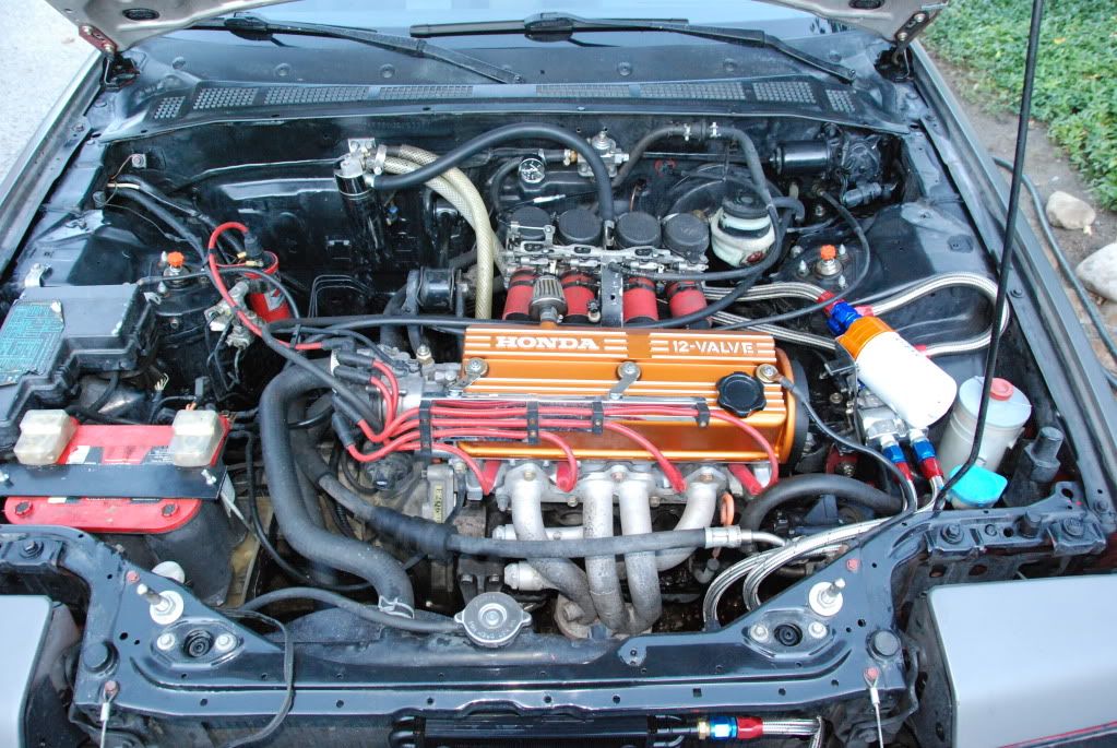

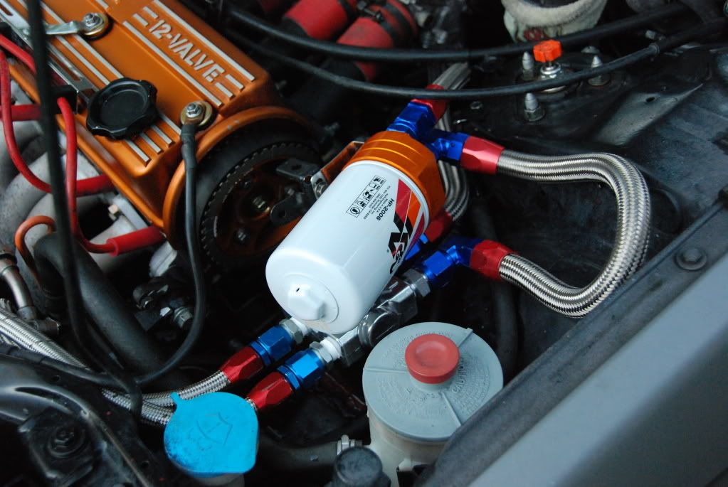

    Wow. I completely forgot that I never posted the answer on this thread. Sorry bout that.
    It turns out that I did indeed disintegrate a rod bearing. There was nothing left of it, but metal shavings in the bottom of the oil pan. The number 3 piston slammed into the head a few times as a result of this, and basically turned the block into garbage.
    I ended up getting a shortblock from the junkyard that was in good condition, and replacing all of the gaskets in it. Sending the head off to the machine shop to have a valve job done with my Bisimoto springs, and getting it decked 1mm. To keep this from happening again I decided to put a big ass oil cooler on it. Along with added cooling the system capacity is roughly 1.5 gallons now. Everything is running awesome now.
    Next thing is to replace the radiator with a 2 core aluminum rad from an integra, and to throw away these shitty pacesetters. Probably gonna go with the OBX headers since it's the only other option. I know I'll have to fix the ports on them, but it's gotta be better than these pieces of crap.
    Oh yeah, and pics just because I can. Please excuse the cooler mounting ties. They're temporary until I replace the radiator. I intend to build an actual bracket for the cooler to sit in.

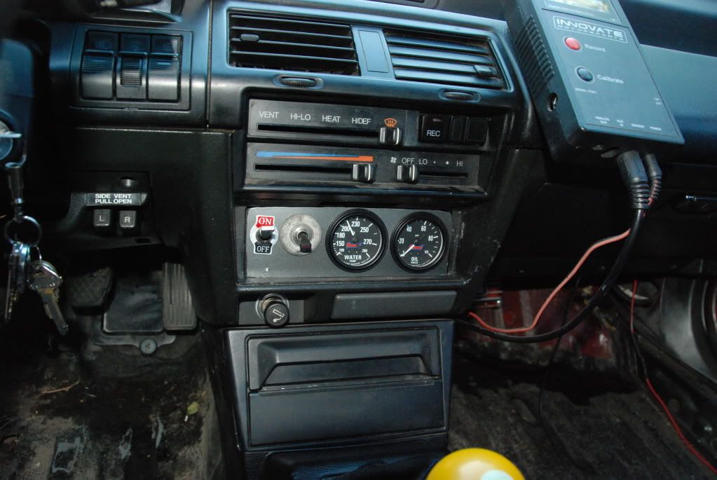

    and an interior shot of my gauges. switch on left is for the fuel pump cutoff, and the switch on the right is for the rad fan. I have it wired so the stock switch still works as well.
    Re: yay! Finally broke something racing!!!

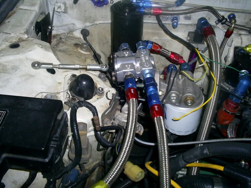

    what oil thermostat are you running, and what size oil lines? your thermostat looks familiar

    turbaka is this the same thermostat you are running? also are you getting any kind of pressure drop with -8 lines, which looks like what you are running. I was debating on running -10 lines from the cooler to the thermostat, as this is the longest run. To compensate for line restriction.
    SEi User turabaka's Avatar
    Aug 2007
    Boise, ID
    1,564
    That is exactly the thermostat I'm running Lost. I'm pretty sure I got the recommendation from you actually. I'm only running -8 lines between the thermostat and the cooler. The lines from the back of the block, and between the filter and thermostat are actually -10. Was gonna do -8 for all of it, but the kit I bought came with -10 lines instead of what was actually listed. So far haven't had any problems with pressure. Stays above 35 psi all the time, and is above 60 psi when I'm on it.

    This is fantastic!
    Is the motor sitting kinda lope eared? Kinda like the drivers side mount needs lifted I dunno.
    I would be nervous all the time about that filter and plumbing being so high up, I would probably use two pressure senders one upper (oem) and one upper. lol
    Looks great man and love the master cyl bootie!

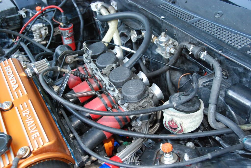

    before I found this site, I was telling my buddy I wanted to buy a plasma cutter to duplicate the intake mani from steel tubing to run sidedrafts, I was trying to figure out what carbs to use.
    How do the bike carbs work out? my thought on that was the motor they came from was 1000cc? and the 2.0 is obviously approximately 2000cc

    Yeah the motor does sit kinda lopsided. I've never been able to figure out why. The motor mounts are all fresh, and installed correctly. I'm thinking it might be a byproduct of maybe having the wrong front mount. Since these motors came with stamped, and cast brackets that were slightly different.
    I might add another pressure sensor sometime down the line. There's a spot to put one on the filter housing, so that would be the highest point in the setup.
    razordave. That's exactly how I built this manifold. Cut the flange out with a plasma cutter, and welded four pipes onto it at the right angle. Then connected them on the underside for a balance tube.
    If I remember right the carbs are 34mm keihin's from a cbr600. They give way better throttle response than the weber I used to have, and coupled with the 8 pound flywheel it's like driving a bike now as far as the throttle goes. They're getting a bit small though. They were plenty big before I rebuilt the head and had 1mm shaved off of it. Now it's seeming a bit on the small side. Next set is probably going to be Yamaha R1 carbs if I can't find a set of 44mm mikunis. The thing to remember is that these carbs are sized for motors that wrap out way higher than we do. If a 1000cc bike is going to 10k, and we're only going to 7 that's a lot of air going into that little tiny motor.
    Unfortunately no build thread yet. I'm a lazy ass, and I haven't kept my foundation membership up to date. One of these days I'll get a builld thread going though.
