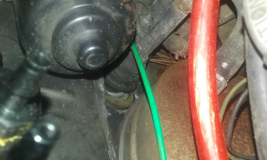

    Well small update. The other week while sitting in stop & go traffic my clutch pedal started sticking. I was like 4 miles from my house. Thought it was the throw out bearing took trans off and everything saw it was fine. Had a replacement on the way figured I'd just replace it & the new o e didn't fit -_- so frustrated left it alone to drink. Then next day I pulled on my clutch cable and the fucker wouldn't move.... Guessing the manifold melted the inner section of the cable. Got a new one for 15 bucks and suckers works great. Grabs even better than before.
    I need to get my ramhorn ceramic coated.

    I had a similar problem like this about 5 years ago I pulled the transmission checked everything out everything was good .come to find out it was a little metal mechanism that holds the clutch cable under the dash broke. So everytime I hit the pedal the metal would just bend. So had to cut it out .now I have a big washer that hold the cable to the firewall

    I run my cable along the back of the engine uder the intake.
    Sent from my SM-T800 using Tapatalk
    I do the same. Works fine & I recommend it.
