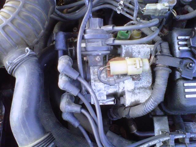

    Confusion is right, but I think I have a TEC. Does this look like a TEC to you guys?

    It is a TEC distributor.
