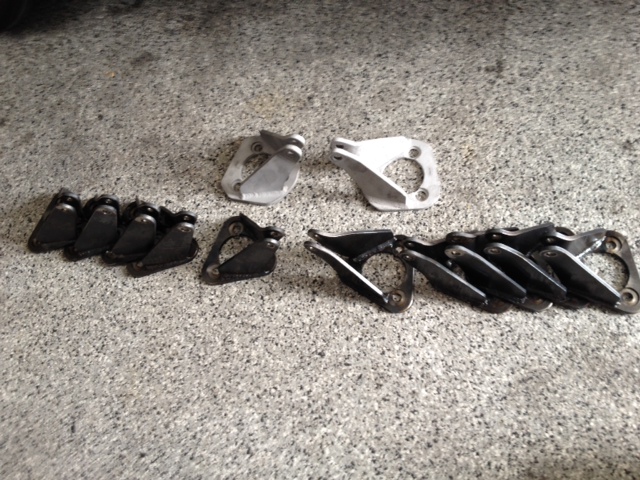

    Well the fabricator had a family emergency, but here is a pic that he sent me of the bases. He said he has all 5 sets fully made, but this was the only pic he had before he left to deal with emergency...I will be media blasting them and powder coating them as well.

    Picked them up today. Test fitting shortly. They look nice. Pics to follow....

    Here they are. Slightly redesigned. Sill need to clean them up and powdercoat them..
    How much for a set not powder coated?
