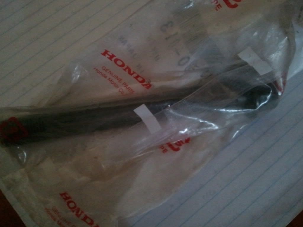

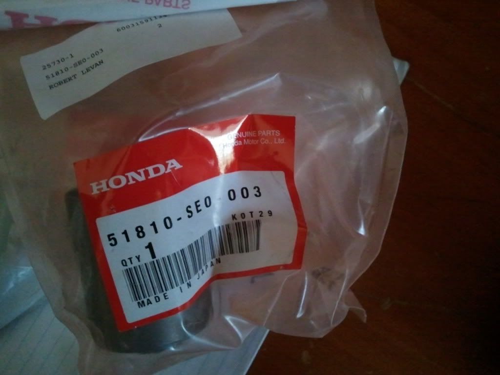

    I just got my bushings, nuts, and bolts from honda. That was just about 70 for all of them. Now to put them on and then alignment and inspection. hopefully i dont need tires on top of all of this too
    bushing
    bolt
