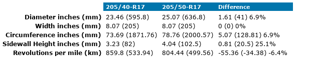

    Re: 89 accord suspension issues
    Your tires are to big.
    215/40-17 23.77” 102.4%
    205/40-17 23.46” 101.1%
    These sizes are the same size as stock. (are pretty close)

    from the online tire size calculator
    The reason your rubbing is cause your new tires are almost 1.60 inches taller. I think your prolly gunna have to get new tires and recoup your losses by selling the current tires on ebay.
