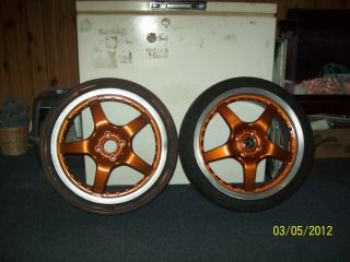

    Hey guys just painted my wheels,what do you think.They were pretty scuffed up so had to sand them down and decided to paint them.

    Whoa awesome! They look really cool. Post pics of them on the car!

    Nice job!

    What did you paint the rims with?

    I scuffed them with scotch nylon pads because of the rivets around the outside.sanded the rest with 220 then 400,primed with etch primer then shot them with VHT engine paint.Left them dry for 4 days then 2 coats of clear.

    Nice job on the wheels!

    Nice!

    Thanks guys I wanted something different, I also just painted my old rims to put my snows on.
