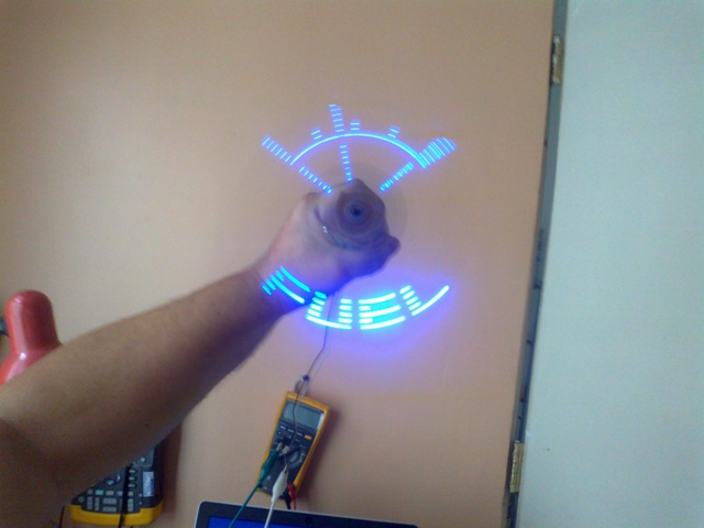

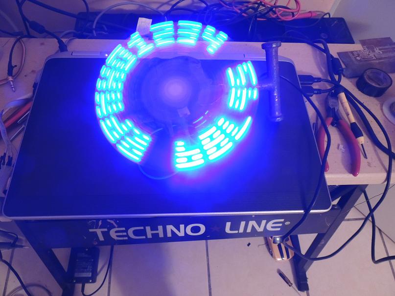

    Long time since the last update to this thread.
    But here I am again with another version of an HUD. Its based in a POV (persistance of vision) system where a small motor is spinning and a microprocessor turns on and off LEDs to draw something that seems to be drawn in the air.
    A POV can be purchased by anyone over Internet and there are USB programmers already available to draw almost anything with it.
    I decided to build my own and here is how it is going so far. The idea is to put the POV above the instrument panel to see the car's info as if it was floating in the air right in front of me. It doesn't make too much noise or wind. I guess its quiet enough for the car.
    I am testing here with numbers, but I want to simulate 4 gauges into the same circle, divide the circle in four parts for RPM, MPH, Fuel Level and Temp and draw a small pointer to the current level to make it less busy.
    The next step is to make a heavy duty PCB and add red LEDs to the warning sections of the indicators, because this one is just glued together and I put a lot of flying wires.
    Edit to add another picture.

    Finished the mechanic portion of the project. I used a bigger DC motor taken out of an old deskjet printer to get more RPM / less blinking.
    Hope I can install it in the car today for a quick demo.

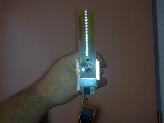

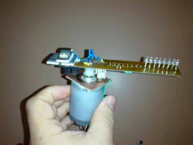

    This is to show how you can see through the device while it is spinning at high speed.
    Also a couple of views of the motor and pcb.
    I see the following technical things that we need to resolve:
    1) We need to put at least one brush to pass the + to the spinning PCB, the negative can be sent through the motor shaft.
    2) Add counterweights to balance the PCB, or there would be a lot of vibration
    3) In this case I selected a thin PCB because I wanted to reduce weight, but I fount it get twisted with the speed and the components. A standard 3mm PCB is better
    The idea is to put the motor right on top of the plastic cover of the instrument panel, so the word FUEL can be seen below the steering wheel and the needle indicator on top. I will use the mirror adjusting control to navigate through different things to display.
    In case you didn't notice it, the fuel level is almost half tank hahaha.

    Thanks everyone for your comments & ideas.

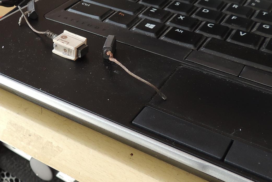

    I finished balancing the PCB by holding it with a screwdriver and adding/removing counterweights I got from a ceiling fan balancing kit.
    Then added the positive brush from the brushes left from my recent alternator fix.
    The motor works quieter and the brush works very well.
    Time to install it in the car, or at least on top of the cluster cover

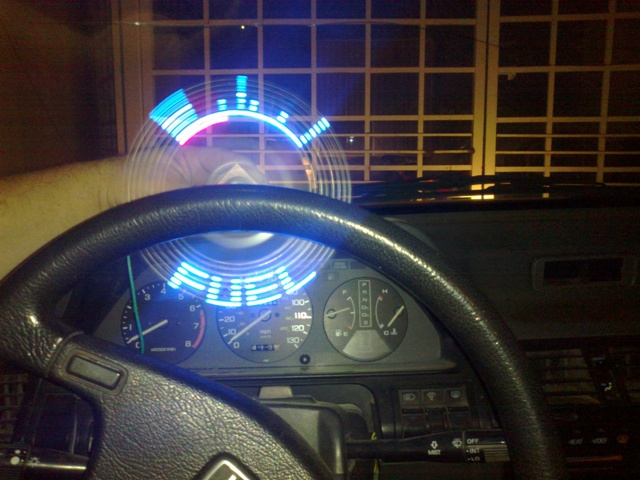

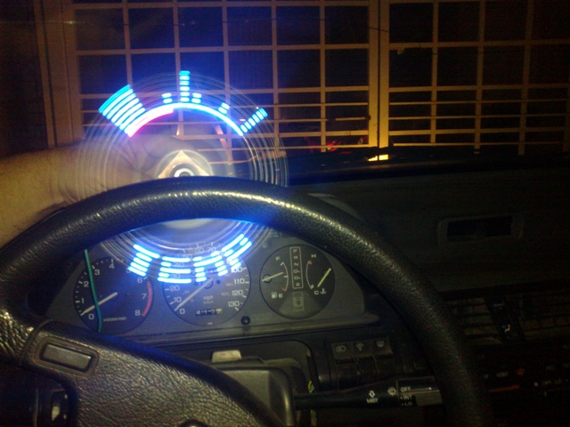

    Here is a quick test-fit in the car.
    The LEDs are too bright for the night but that can be fixed by adding another resistor value in series with the LEDs.
    The camera's flash reflects back in the LEDs, so we see those circles in the picture, but they aren't there live.
    The objective is to eliminate the ghosting generated with the HUD reflected in the windshield and be able to see it during the day.
