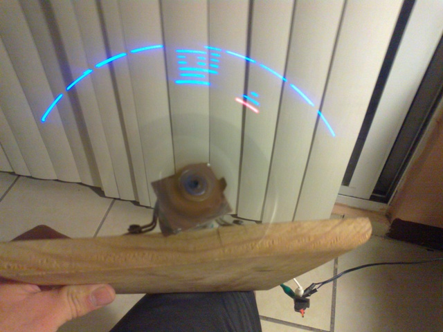

    The first picture is one of the best pictures my camera has taken of this project.
    Its hard to capture a complete picture due to the slow refresh rate.
    But if you remember It happened also with the VF display.
    Here you can see the 'flying' effect of the graphics.
    The second pic is how it looks in the car at daylight and shows the size of the graphics related to the standard gauges.
    Added a third picture to show the POV off. I put it temporarily in a piece of wood, because there is a lot to do with it yet, like adding the Bluetooth module to be able to receive the real information of the car.

    I can draw almost anything at this time.
    Before I put it permanently in the car I am going to double the resolution and re-design the PCB to make it self balanced, I mean, put the same number and type of components in both sides of center of the PCB.
    The left and right arrows in the pics will be connected to the turn signals of the car and will blink accordingly.
    Edit, there was room for a third picture, so here it is. This is how it looks w/o the turn signal arrows which will be normally off. Also it barelly shows the red LED of the base of the floating pointing arrow. It looks much better live.
