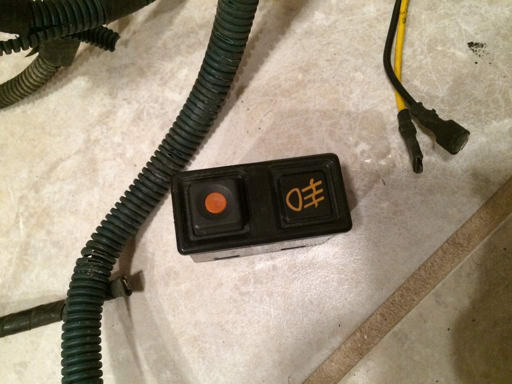

    hello all
    I know this qustion has been asked time and again. I picked up some auto Si fogs from local junk yard. ( Prelude SI)I have most of the wiring harness, but its not complete. it includes connections to lights, the relay, ground wire and three groups of leads. one set has two wires: yellow/green and red blue. I think these are the switch leads. the two others groups coming of the harness have 3 leads each. red/white, red/greem and red/blue. they are the same colors for both of these groups. I also have a oem accord switch with the foglight emblem and red dot botton. on back are three contacts one clearly marked ground. back to the harness. I dont know were the three lead groups should go or how to wire them for my 89 honda lxi,
    Pease help.
    Attachment 6465
    Attachment 6468
    Attachment 6466
    Attachment 6467

    Well, the OE switch doesn't light. At all. No bulb. So you can save yourself that trouble. The relay mounts on top of the DS shock tower and the ground screw is next to the radiator on the DS kinda toward the top. The wires are wrapped in some kind of black plastic that resembles shrink wrap that hasn't been shrunk. Here's a pic of my engine bay so you can see where the relay mounts.
    strange. the orange Dot on all 4 of my oem fog switchs lit up O.o
