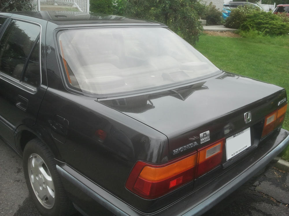

    Does anyone know how to remove a CB antenna without scratching or damaging the window? Any tool I should use?
    I also took a video of what it looks like;
    http://www.youtube.com/watch?v=4ENswK9kkkg&feature=plcp
    Thanks!

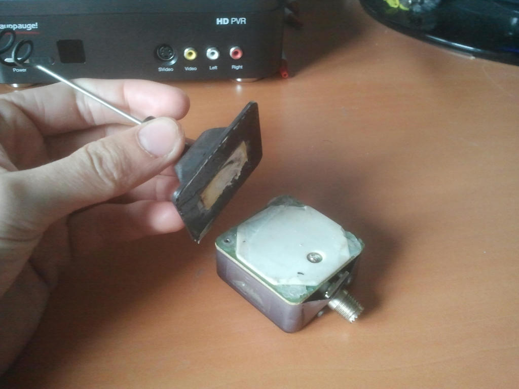

    This looks like it might work. If you have an Xacto knife you can buy blades that look like tiny, thin chisels. I have used them. Also, a singled-edged razor blade (the type used in scrapers) might be able to get under the mount.
    http://www.ehow.com/how_5507116_remo...nna-glass.html

    You were right, it was only glued and this is exactly the tools they used at the garage who took it off for me.

    Oh, and the easy way to get those things off the window is a plastic trim tool. The other method (which also works awesome for getting any 2 sided taped emblem or whatnot off) is to use a little WD40 and some non waxed dental floss to saw through the tape.

    Dental floss. That sounds like a good one. I have used monofilament (fishing) line the same way. It works, too.
