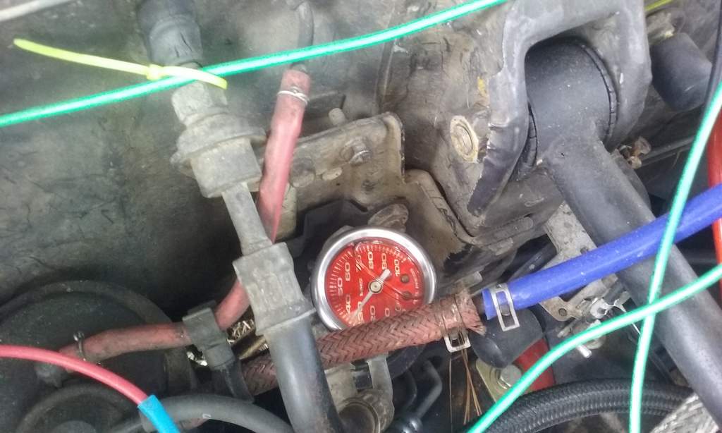

    SEi User Shane86's Avatar
    Feb 2016
    Florida
    1,016
    Re: How-to Fuel Pressure Gauge (F.I.)
    I want to do this so i'll try to update it with pictures but in the mean time does anyone have a picture of their setup they could show.
    i only used two parts that came with the little kit the gauge and the bolt
ID:	8178   Click image for larger version.
