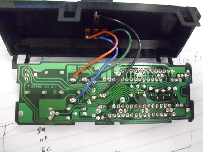

    M dash clock went out last week. When the ignition was on and the headlights were off it would show 1:00 and would not count time from there. Since I have an electronics engineering degree I decided to see if there was anything I could do to fix it before looking for a good one in a j/y.
    I opened pried it open.
    All the parts looked OK except 90% of the solder joints were bad. If you look close you can see the crack in the solder joint in the pic below.
    I checked all the resisters and diode. All were good so I re-soldered everything and tested it. The clock works again.
    Thought I should share this in case it might help anyone else.

    Thanks for the heads up. That's good info. The main relays are also plagued by bad solder joints.

    Sounds like bad solder joints to me. There really isn't anything behind the clock other than wires.

    Snooz is right. Bad solder joints is most likely your problem. Open the clocks and re-solder all the solder joints.
