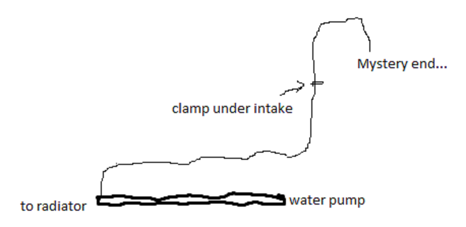

    Having a similar problem, but the hose to blame finally blew off, had a 1" crack in it... The problem now is, I don't know where it's supposed to go. It comes out underneath the carburetor, and goes towards the driver's wheel well. And that's all I know. I've felt around, pulled the hose everywhere it can reach and I can't find where it plugs into, though it's somewhere above the alternator, behind the waterpump area. Any ideas?
    EDIT: It seems to be the longer of the two hoses that pass under the intake manifold, I can see the elbow where it starts to go under the manifold, can feel the clamp holding it on the bottom, but still can't find where it plugs in...

    It's the hose coming off the last outlet on that diagram, after hose 15. It's a feed hose, water comes out when the engine is running, I need to find out where it plugs in, any idea?

    Here's a (crude) drawing of the hose.
    Okay, it's hose number 13 from the water pump schematic. Any ideas where it goes?

    Okay, so I feel stupid. The line was cracked, I had meant to fix it, and got distracted, and ended up putting another line in it's place when I put the carb back on. It goes to the carb, probably to heat it, or something. Thanks for those that tried to help, and I hope my absentmindedness might help someone else
