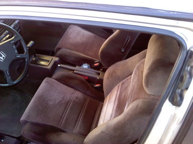

    why do these door panels split and how can they be fixed, at the top by the window..
    Im looking at a pristene hatch with 84K miles, otherwise the interior is remarkably preserved.
    All black moulding on exterior is either peeling off or faded 13 shades of grey...
    Lxi, no rust
    champaign color, with white hood and chocolate interior their asking 1000 for it but Im skeptical as of yet

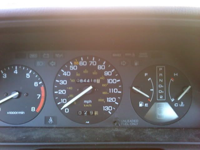

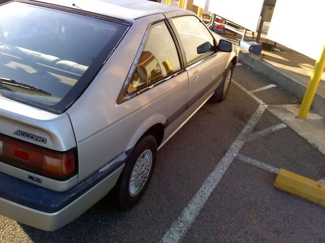

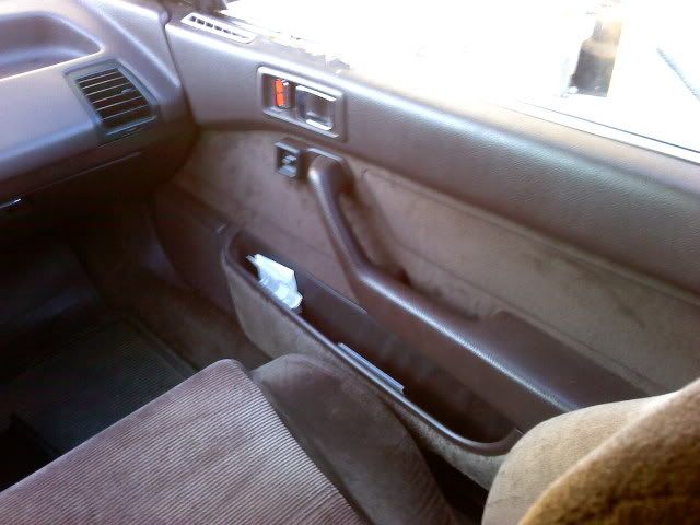

    yeah .. i know
    Ive been keeping an eye out for these simply because there arent that many of them around here. This one having such low mileage on it seems like a cherry pick to me. Still plagued with oil leaks from the age though.

    roodoo the oil leaks are simple and easy to fix, pretty much any car from this era will leak oil, new oil pan gasket, valve cover gasket with grommets, dizzy o ring, oil filter adapter gasket, possibly cam seal or crank seal, nothing beyond what you are capable of, if you come down to vist again, get your material for the pieces on the doors and i'll cover them for you. I need to redo mine with imitation leather anyway. I know of several sites where you can order the foam backed material really reasonable.

    I think he was talking about the vinyl at the top of the door upholstery, it also splits and cracks, it's pretty straightforward to replace but takes time and it's tricky to stretch the new vinyl around the ends, especially the back.
    Re: hatches..why
    yes Snooz that too though, that stuff is peeling off on the pass side too , car must have been parked with right side facing west. lol
    can you believe the mileage, hell my 2004 ford has about the same mileage and considered "low mileage"

    the door panels are really easy to swap over, i took black tops off a coupe interior panel to switch from the tan tops when i had the 2 tone dash in there. there's a bunch of screws and rivets that hold the back of the panel together, took me about an hour if i remember right to swap them over. and another thing i dont know why the hatches do this almost every one i have seen is ripped up front near the vent

    Oh, yeah, that too. Honda figured out how to keep the dash and rear decks from splitting all to heck by the 3rd generation, but the tops of the door panels were overlooked. I will probably take my panels apart at some point and take those pieces to the upholstery shop. My rear panels are doing it too, but as I have a coupe, it's a little more difficult to remove those. Every coupe at the yard is splitting just like that. I haven't noticed it on the sedans though.
    I'm trying to think of a patch for that that won't look lame, but so far, I'm coming up empty. Maybe someone else has a better idea than I do.
    Re: hatches..why
    yeah every hatch i see seems to be split there, i dont see as many sedans split there but i know mine was starting to lol
    Re: hatches..why
    the material is stretched tightest there so as it shrinks over time it starts to rip. also near the vent windows it does the same thing. There are just screws holding the panel in no rivets. The plastic piece under the material tends to crack and break, but can re repaired really easy with fiberglass from the backside. the material is vinyl with 1/16 foam backing, thats where it gets it's shape, I know of several sources for that particular material, it's hard to find if you don't know where to look.

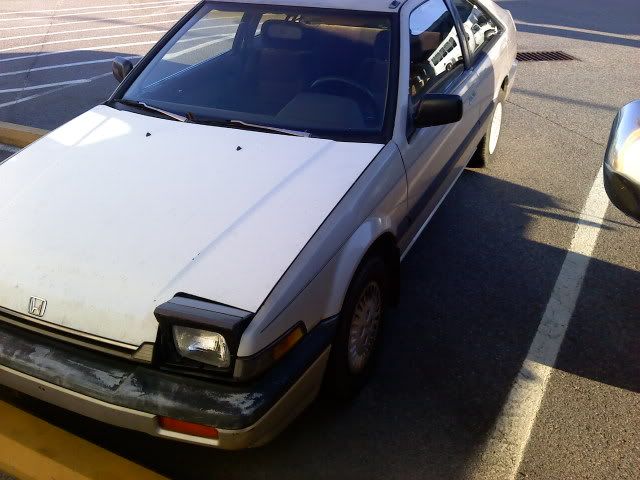

    well, it's ours now...
    why why why.... now there are 3 three geez in the yard. woo hoo.
    The guy broke the rear compartment slider since yesterday, friggen pisses me off, it was mint. People just don't know how to operate that thing.
    He bought the car at who knows how cheap, to resell. I was hoping he would let me to it first, but anyway since it was so cherry I bit the bullet. Even in the shape it is in there are still lots of areas of attention needed to restore it.
    It is an 87 Lxi hatch.. auto, yes slushbox but I don't care about that really it's not for racing.. not yet anyway, I just want to get it like new.
    It has the crappy armrest, which is broke off actualy, just like I figure one would but just never saw one broke right at the "pod" base. I need an SEi armrest like my DX. Time to go yarding.
    I need visors, console, improved electric window operation, radio stereo, possibly LT side axle cv ( I may have one from the swapped sedan)
    RT side headlignt wont flip down, Needs some paint work and trim. and still has oil leaking .
    i looked in the usual places and I do not see a spec of rust on this car!
    [IMG][/IMG]
    Here is the worse view I neglected to reveal yesterday....

    good deal, get it running good and solid and bring it down one weekend and i'll help you fix the cosmetic stuff. I owe you one for finding me my rear bumper anyway.
