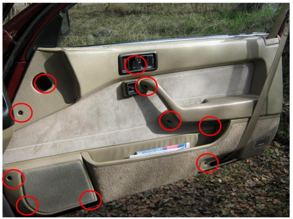

    Start by removing the door panel. There are 10 screws holding it on.
    Remove the handle trim. The panel is held on with a number of plastic clips. If you just yank on the panel, they will simply pull out of the panel. The panel will be damaged and the clips won't hold anymore. Then your panel will rattle when you drive. Carefully pull back the panel and use a tool to pry the clips away from the door. They sell special tools for this purpose, but I use a gasket scraper.
    You just want something broad and flat to get in between the clip and the door. The panel is still held to the top of the door by a series of clips. To get it off, pull out slightly on the bottom of the panel so it clears the door handle when you pull it. Then grasp firmly on the corner of the panel and pull up firmly and quickly.

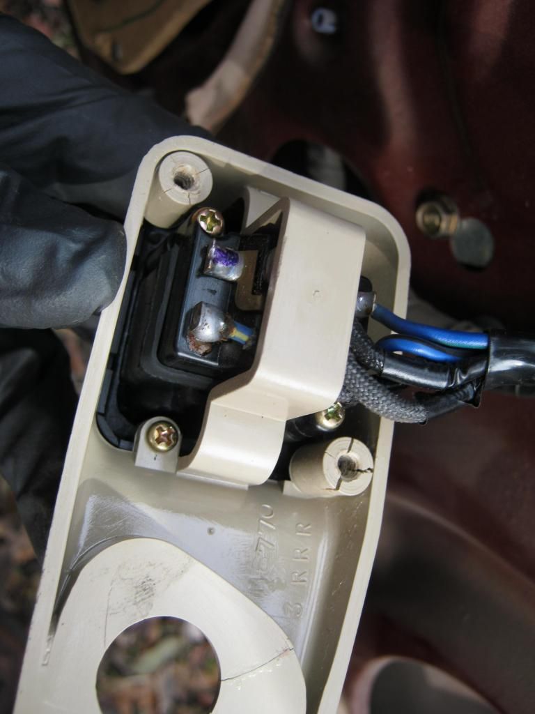

    Disconnect any wire connections. Depending on the door and your submodel, there will be a window switch and a courtesy light.

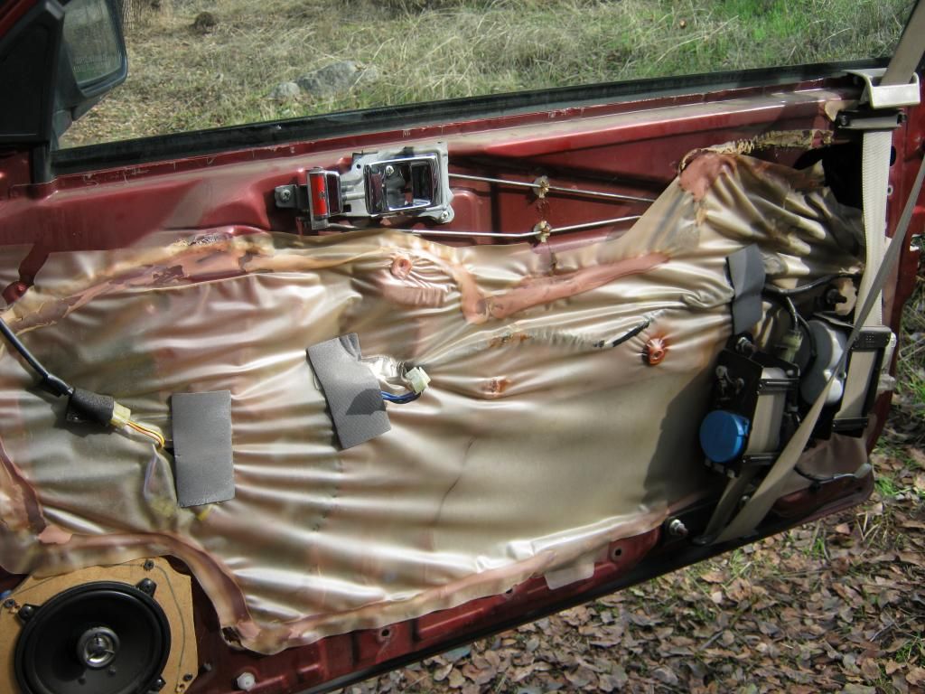

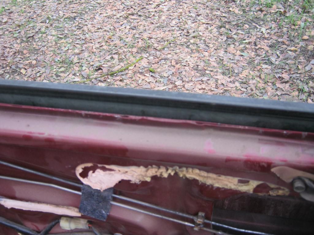

    Behind the panel is the moisture barrier. It is a thick sheet of plastic stuck to the door with putty.
    The plastic degrades over time and becomes quite fragile. By contrast, the putty turns to concrete. You want to peel back the moisture barrier carefully, minimizing rips, and only peeling back enough to allow you access to the window regulator. Use a sharp knife to cut the putty where needed. In my case, the seat belt is bolted over the barrier, so that's as far back as I peel it.

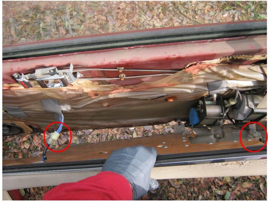

    If you have power windows, at this point, they will be completely disabled. You need to move the window so you can work on it, so remove the window switch from the door panel and plug it into the connector.
    It's helpful to have some Krazy Glue on hand for any plastic repairs you encounter.

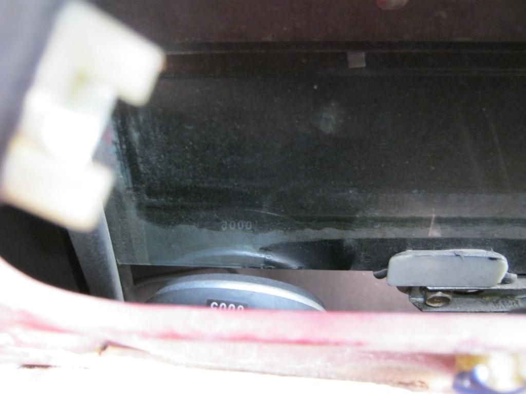

    At this point, I figured out why my windows won't roll all the way down.
    It turns out there is a clearance issue between my aftermarket speakers and the window. I guess I get to deal with that.

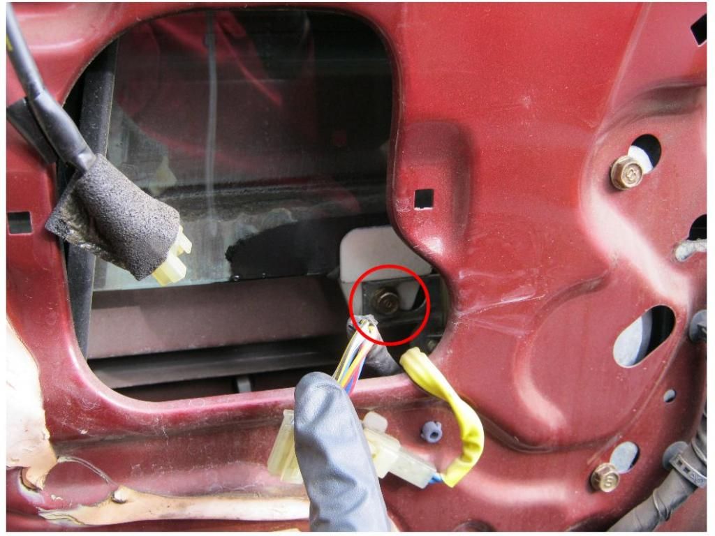

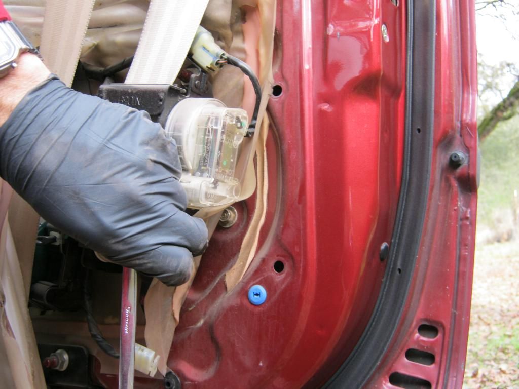

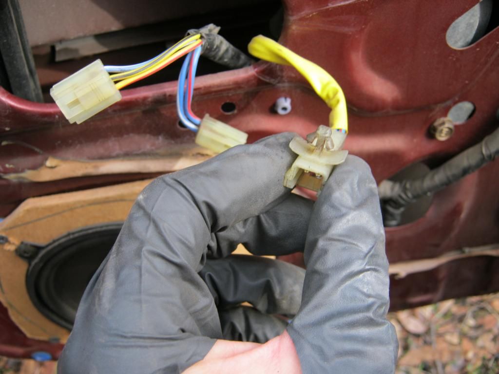

    Disconnect the window motor wire connector. It's this yellow wire that goes into the door. It's held to the door by one of these barbs that are nearly impossible to remove without mangling.

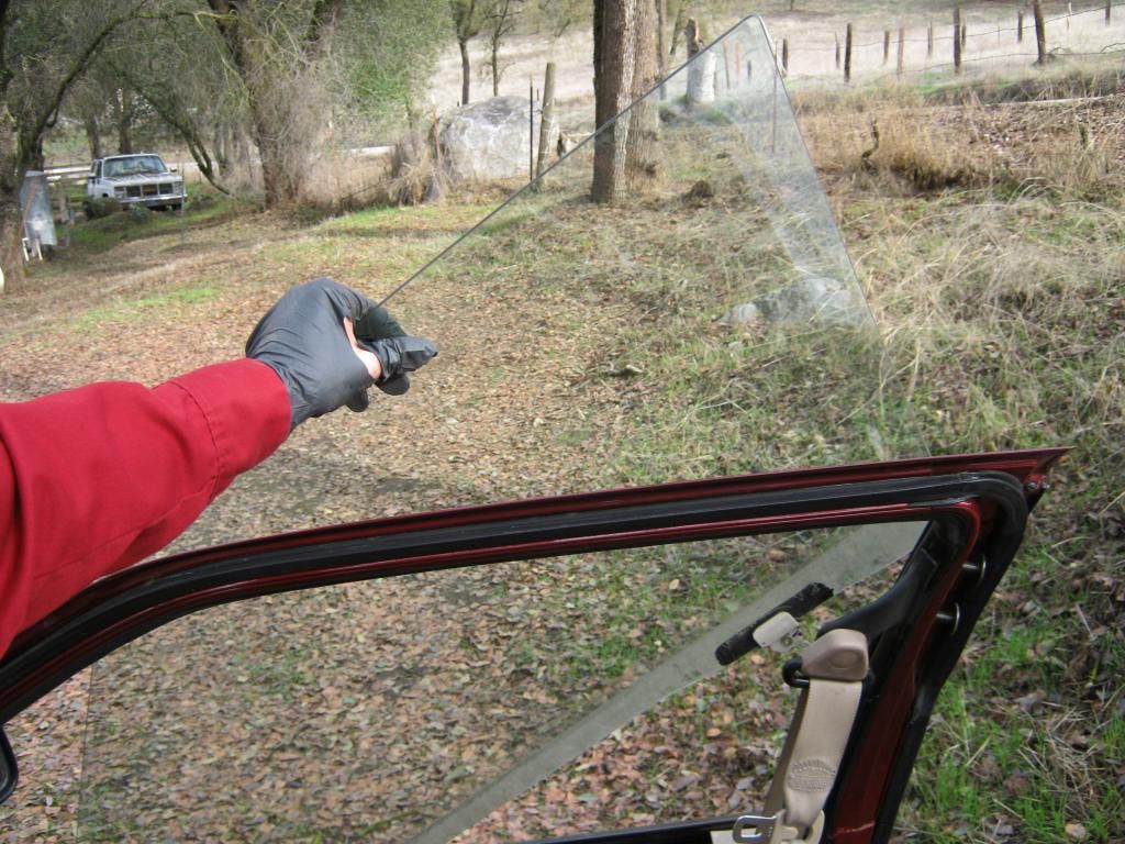

    After some maneuvering, the window comes out like this.

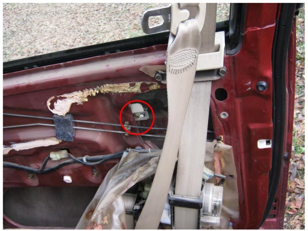

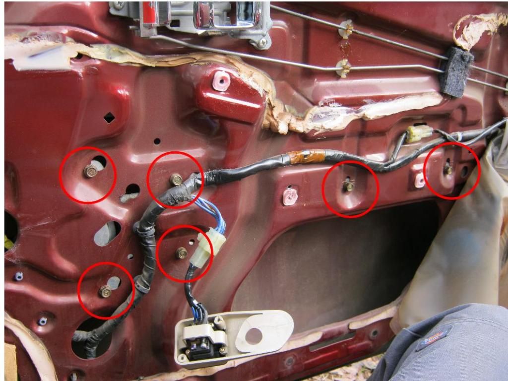

    Remove the regulator bolts. Note that the two bolts on the right are your adjuster bolts. When you put the window back in, be sure to check the adjustment by running the window up and down a few times before putting the door back together. If the regulator is misadjusted, the window will bind in the track and/or whistle on the highway.
    Remove the regulator from the largest, bottom hole in the door.

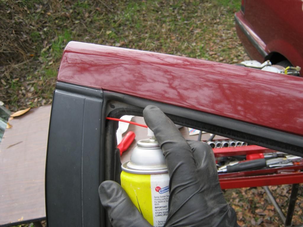

    Take a moment to douse the felt rails with silicone spray lube. They can produce a lot of friction on a window.

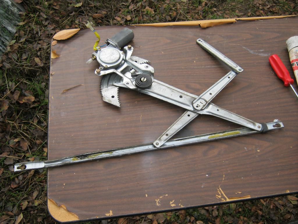

    Here is the regulator.

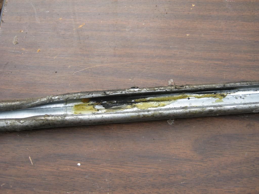

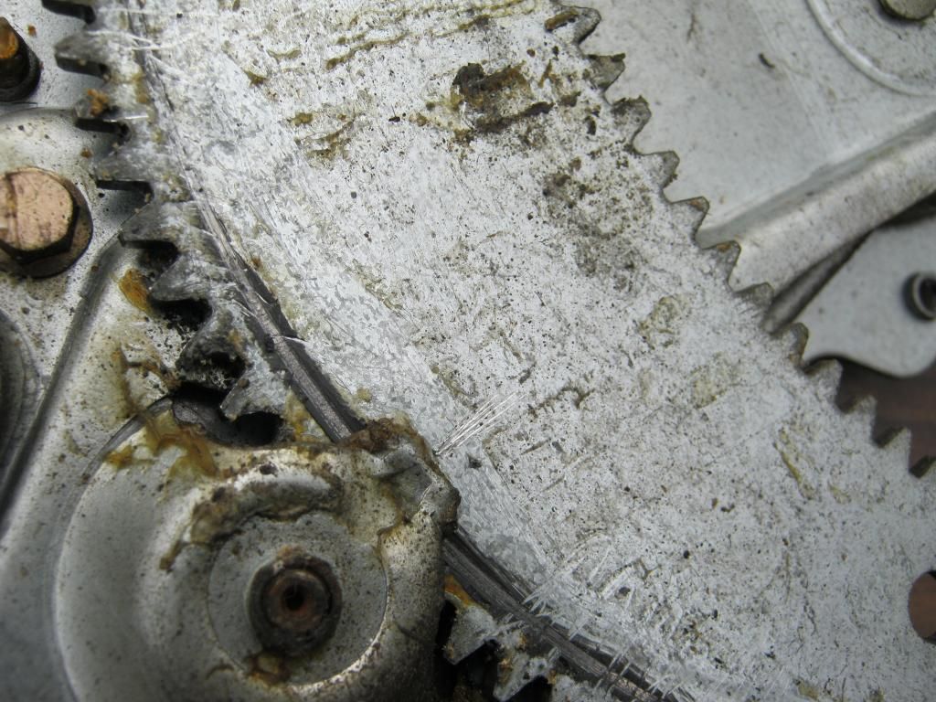

    On mine, the grease is all hard and crusty. A lot of it flaked off when I scraped it. It's not lubricating anything like this.
    My regulator also shows a lot of wear. Notice the worn and cracked wheel. All the other wheels look like this.
    I should replace the regulator, but I'm broke, so I'll just clean it up as best I can and put it back.

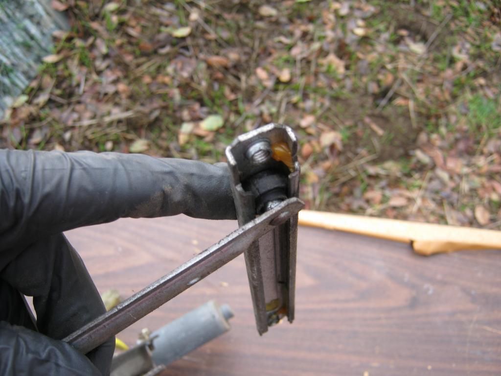

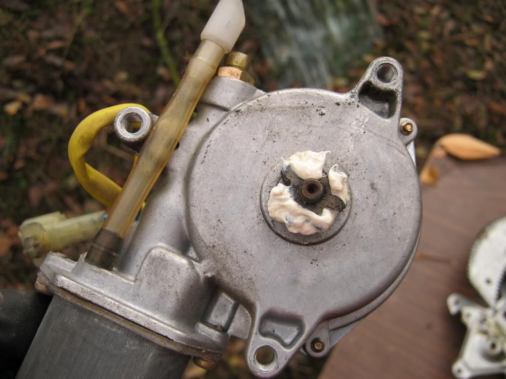

    I removed the motor to be able to clean the regulator better. I scored the position of the motor on the regulator before removing it so I could put it back correctly. The motor is held to the regulator by three 8mm bolts.
    Grease all the gear teeth and the rails. Oil all the pivot points and reassemble. I tend to hog the grease on sloppily and let it distribute itself.

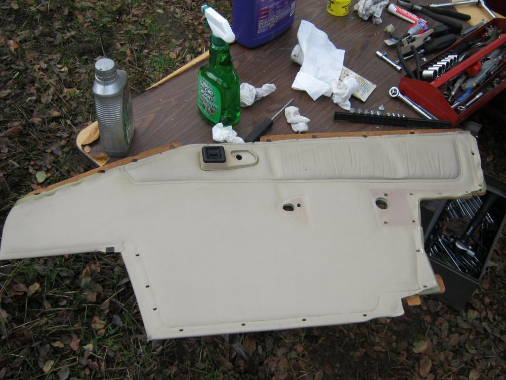

    I scavenged some leather door panel inserts at the junkyard years ago and took this opportunity to swap them in.

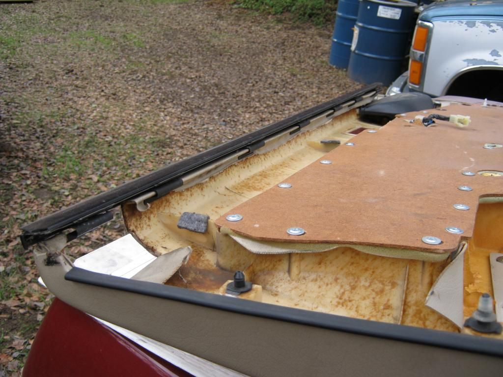

    Door panel reinstallation is tricky and not even the dealership knew how to install these properly. Along the top of the door panel is a row of black metal clips.

    The clips straddle this raised seam on the top of the door.
    If you rest the panel on the door, you will be able to see the clips from the outside of the door. Make sure they clip onto the raised seam or the panel will not sit flush with the window.

    The vapor barrier is fairly rigid. It just needs to stay put long enough for you to get the panel over it.
    I've had this door panel off before and none of the putty was holding, but the barrier stayed in place just fine.
